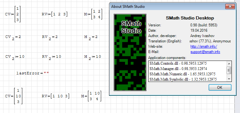

    if possible I suggest to improve the error message when the LHS doesn't fit the RHS (something like "wrong assignment pattern")

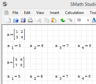

    Andrey,
    a[1 and a[2 do not need the "j" variable. In your screen shot, a[3=a[1,2 in my file and a[4=a[2,2
    I've attached my fileIndex.sm (8.35 KiB) downloaded 1480 time(s).

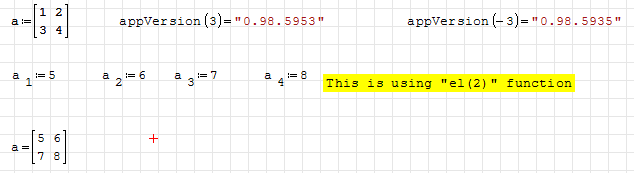

    Linear indexing is a feature to identify an element of a matrix using a single number (base 1 index, starting from the top-left element, proceeding by columns and then by rows]
    [1 2 3 4]
    [5 6 7 8]
    [9 .....]
    Previously it was possible to use el(2) (one-index element) on matrices only in these cases:
    - to set elements in column vectors:
    - to get elements of column vectors;
    - to get elements of row vectors:
    - to get elements of matrices;
    Assigning elements in matrices or row vectors wasn't possible:
    In the meanwhile, a bug was introduced and it was possible to use el(2) in the LHS of assignments for any matrix, but in a wrong way.
    Now it is possible to use this feature to get and set elements of any matrix:

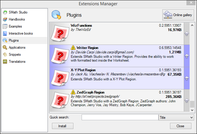

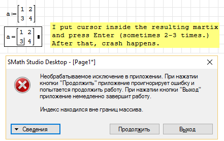

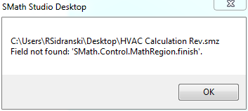

    Mike, I cannot reproduce. I just updated on of my machines to this build. I go into the resulting matrix and the red cross bar "kicks out" into white space. However, on another existing file that was working correctly, it won't open

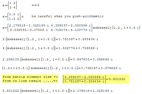

    Hello Collabs,
    From a matrix result, you can do 3 things immediately besides
    conventional matrix algebra [rotation, transpose, rotation, inverse ...]
    1. drag/select, copy/paste element
    2. extract indexed element
    3. post process [arithmetic, function]
    Be careful on [3] versus other CAS [Matlab, Mathcad ...]
    You need to open Plugins tab in Extensions Manager, switch to Online Gallery and find & install all available updates there. After SMath Studio restart you will not see this error anymore.
    I'm working on the wizard which will assist users to do this semi-automatically on every SMath Studio update as it is the most common issue now.
    Davide Carpi 2016/4/20 19:06:00, Mike Kaganski 2016/4/20 20:59:00

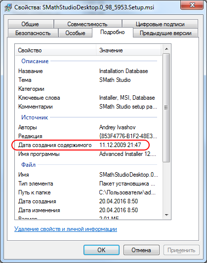

    Why is the content creation date in MSI is shown 11/12/2009?
    Actually, I needed this information when I noticed that this release was released twice: I have been notified by update manager and updated promptly, and haven't been notified again after that, but I started to see files that are "created with a newer SMath version" - 0.98.5953 (the same as mine), but last (fourth) part of version was greater.
    С уважением, Михаил Каганский

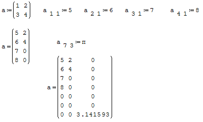

    Spotted matrix definition bug if using Clear():
    Also nested definition is not supported? In a form of
    el(el(M,1,1),1,1):5
