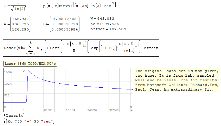

Here, I think the guilty is Smath "erf".
I would prefer be the guilty one.
Any collab is welcome to 'doctor' that one.
Scrap Laser.sm (41.31 KiB) downloaded 1105 time(s).

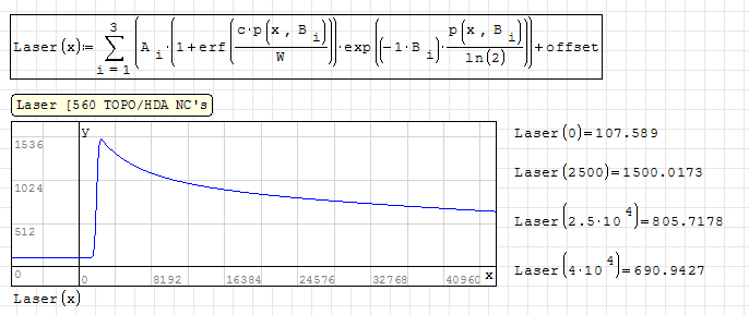

No issues I think,
the guilty is 1+erf()*exp() that should be (1+erf())*exp();
Let me know if there are other issues (erf is part of StatisticalTools)
![2016-04-18 19_55_29-SMath Studio Desktop - [Scrap Laser.sm].png](/zh-Hans-CN/files/Download/qTMe7u/2016-04-18-19_55_29-SMath-Studio-Desktop---[Scrap-Laser.sm].png)
Scrap Laser.sm (35.36 KiB) downloaded 1115 time(s).
