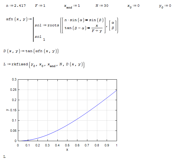

Looks like the algebraic relationships need to be separated out:
Lens_stv.sm (363.89 KiB) downloaded 1488 time(s).

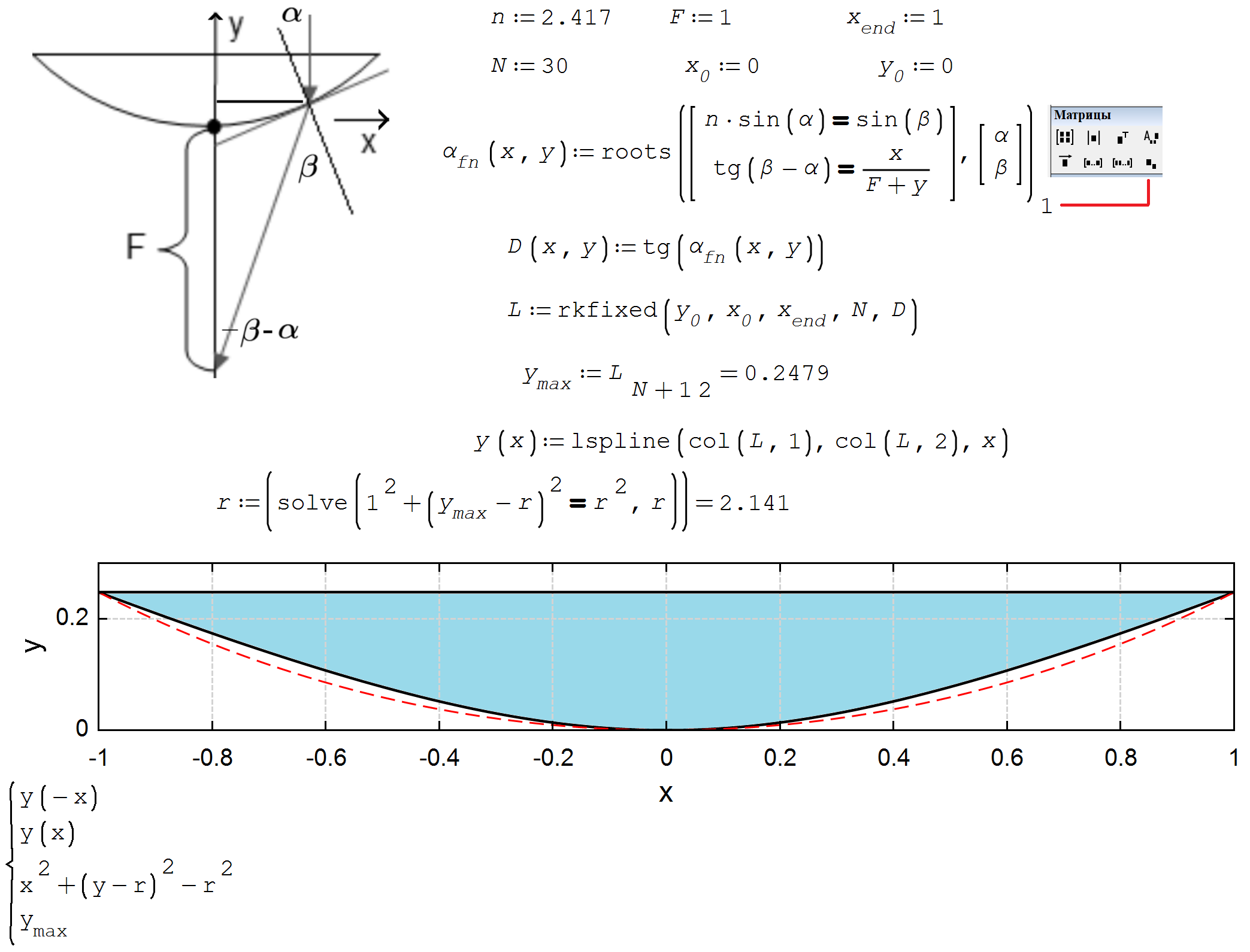

New question.
Can we use here the Mathcad-block for ODE solution?
See please the attach
Lens.sm (118 KiB) downloaded 1398 time(s).

The solution at N>30 and with units
Lens-Euler-RungeKutta.sm (59.18 KiB) downloaded 1452 time(s).
