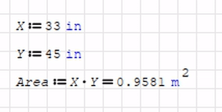

Does the free version of SMath limit the units you can use? I'm trying out the personal version and where I input X inches * y inches it gives m^2 result. When I double clicked on the unit, there is no in^2 option under the area tab.
#28 Posted: 2022/8/30 22:59:24
26 likes in 155 posts.
Default units are metric, but you can change the result units. This is SMath basics. Probably a good idea to read some of the manuals or intro documents. There are some topics that discuss the use of imperial units already. Do a topic search for “imperial”. Good luck.
#29 Posted: 2022/8/31 11:22:28
598 likes in 1,380 posts.
Results shall be mostly shown by SI base units (m, s, kg, mol, cd, K, A).
For example, result is neither mm^2 or acre too in your example.
SMath supports American or British units, but there is a trick.
For inch or inch^2 or anything else beside SI base unit, you will need to enter it manually.
