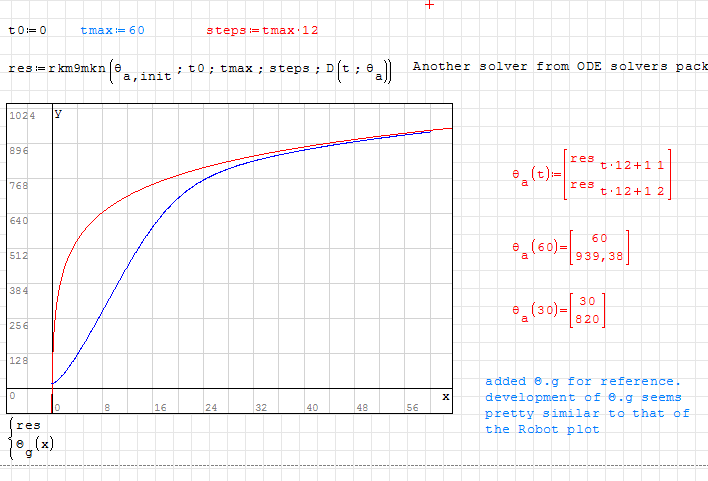

I have realized a pretty crucial mistake in my equation. The definition of Θ.m was completely wrong. I mistaked it for initial value/temperature, but it turns out it is actually θ.a.
I would really appreciate if you could help me rewrite all the expression in the correct format (hopefully the definition of Θ.m is the only missing puzzle)
Thanks a lot4.2.5Steeltemperaturedevelopment-reply-2.sm (65.42 KiB) downloaded 961 time(s).
#8 Posted: 2017/10/26 04:00:12
See the bottom of the worksheet. I do not know if this is correct (you should recheck your variables and equations).
As you could see, there were two solvers used because the problem appeared to be stiff.
4.2.5Steeltemperaturedevelopment-reply-2-1-corr.sm (70.73 KiB) downloaded 962 time(s).

#9 Posted: 2017/10/26 04:40:44
hanskl
hanskl
7 likes in 158 posts.
4.2.5Steeltemperaturedevelopment-reply-3.sm (80.73 KiB) downloaded 1000 time(s).
The plots are finally starting to resemble that of Robot!
I have made pointed out the one variable I am uncertain of in the bottom of this file.
It seems the time is still in minutes, but is the temperature in Celsius?
Is there a way to return the temperature after t minutes? In the snapshot from Robot you can see Oa,max=940,96°C after treg=60,00min.
Ultimately, the goal is to have the equation return the temperature after a given time θ.a(t).
#10 Posted: 2017/10/26 04:53:40
hanskl
hanskl
I think I found a solution to return the temperature after a given time.
There might be better solutions for this though?
#11 Posted: 2017/10/26 05:14:39
As you have points from the solution you could make a function from them by spline interpolation (for example).
See the attached file. By the way, you do not need to many steps for these ode solvers.
4.2.5Steeltemperaturedevelopment-reply-3-corr.sm (89.88 KiB) downloaded 994 time(s).
