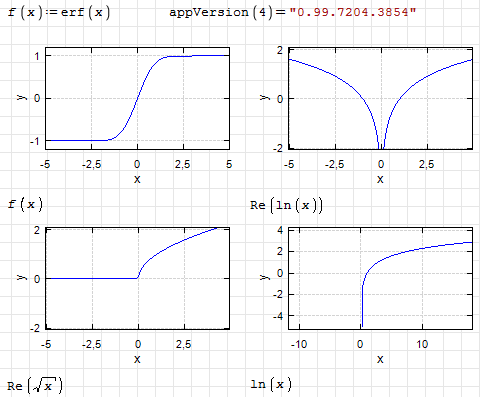

So nice X_Y when it accepts, so deceptive in elementary math.
erf(x) is not scalar in Smath.
In fact a very involved approximation [Mathematica 4.0]

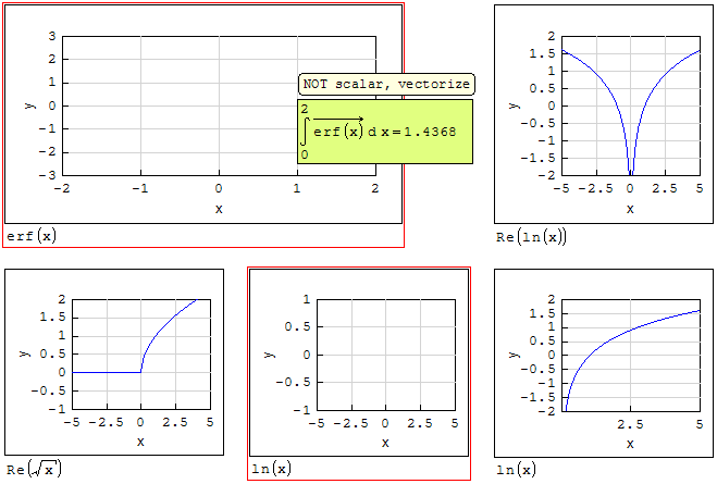

#2 Posted: 2019/9/28 07:54:36
1,532 likes in 1,838 posts.
Problem with erf(x) appears when you use functions from external plugins in the region directly. I will see if it is possible to solve the problem in the general case.
sergio 2019/9/28 08:20:00
#3 Posted: 2019/9/28 09:26:05

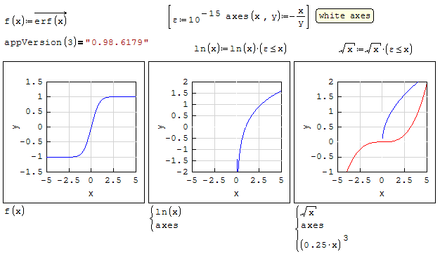

Thanks Viacheslav,
In the mean time, attached doctoring may apply to other SS.
