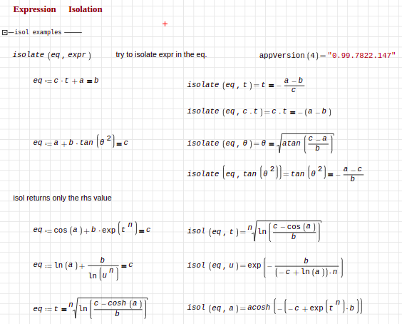

Does smath know how to do that?
Yes, this worksheet is "pluginless" and can isolate expressions from an equation in some cases.
isol_n2e.pdf (52.97 KiB) downloaded 343 time(s).
isol_n2e.sm (73.81 KiB) downloaded 647 time(s).
For instance, it works also in the SMath in the cloud: https://en.smath.com/cloud/worksheet/HpYWFrCC
And if so, is it capable of doing simplifications when doing so with more complicated equations?
Simplification and isolation aren't the same. The exposed concept can be extended to develop a series of rules to apply to simplify expressions for some type of 'simplify' function, or rules can be added to solve more complicated equations.
o_o

Razonar, that was mindblowing

This is very good homebrew function. Thanks Razonar.
