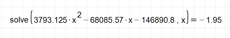

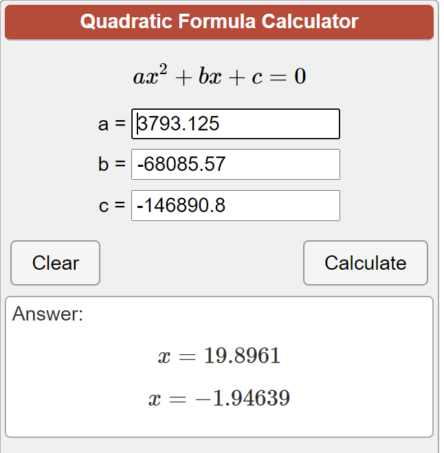

I am trying to solve a quadratic equation using solve(2) but sometimes I only get 1 number as the answer but I should be getting two numbers (see the attached files). How can I solve this problem?
Thanks in advance.

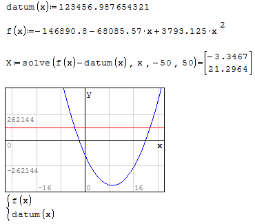

How can I solve this problem ?
1. Lagrange polynomial format is Bible in maths.
2. Always plot first.
#3 Posted: 2021/1/29 20:50:56
PedS
PedS
0 likes in 6 posts.
That did the job!. Thank you
