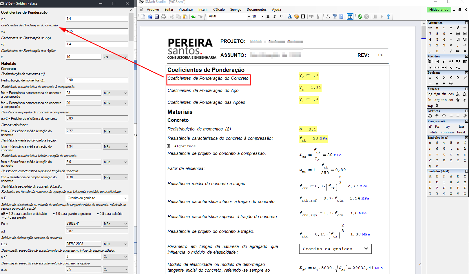

Hey guys,
It's possible to not show an specific text on smath viewer? I know that all inside a closed area region don't show, it's possible to do this with some trick?
Thank's!
