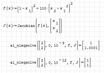

SMath Forum SMath Studio Questions al_nleqsolve 1 Pages (2 items) al_nleqsolve - Messages Go to last post #1 Posted: 2024/9/24 13:27:58 Valery Ochkov 66 likes in 690 posts. Group: User How to get a correct answer?al_nleqsolve.sm (9.71 KiB) downloaded 1386 time(s). #2 Posted: 2024/9/24 19:26:40 Alvaro 1,123 likes in 1,795 posts. Group: User Hi Valery. You can power the solver specifying the Jacobian.al_nleqsolve.sm (12.62 KiB) downloaded 1398 time(s).Best regards.Alvaro. 3 users liked this postValery Ochkov 2024/9/24 20:28:00, sergio 2024/9/24 23:33:00, ioan92 2024/9/25 16:57:00 1 Pages (2 items) New Posts No New Posts
