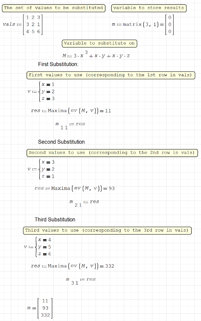

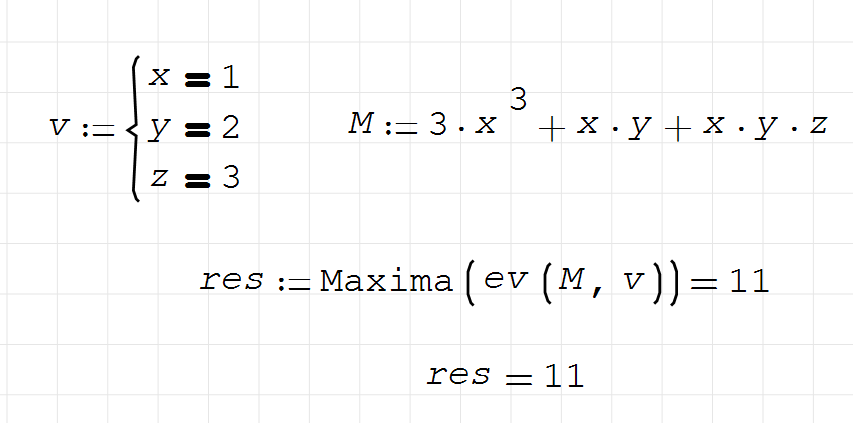

I am putting the following lines:
As you can see, I am using Maxima plugin and the Maxima function ev() to substitute values in the symbolic variable. I have some specific questions:
1.) Is there an alternative way to do this kind of calculations without using the Maxima plugin?
2.) v is a system of values, each value is an equality, is there an automatic way to generate a system of values?
Thank to all the people that could help.

What I want is to iterate over a set o values to substitute in a variable a store the results in a variable, something like this:
Is there a way to do this substitutions in an iterative way?.
I mean: using a set of programming lines?
In this worksheet I copied and pasted the lines to perform the iterations, but in a general problem solving it is desirable to iterate automatically.

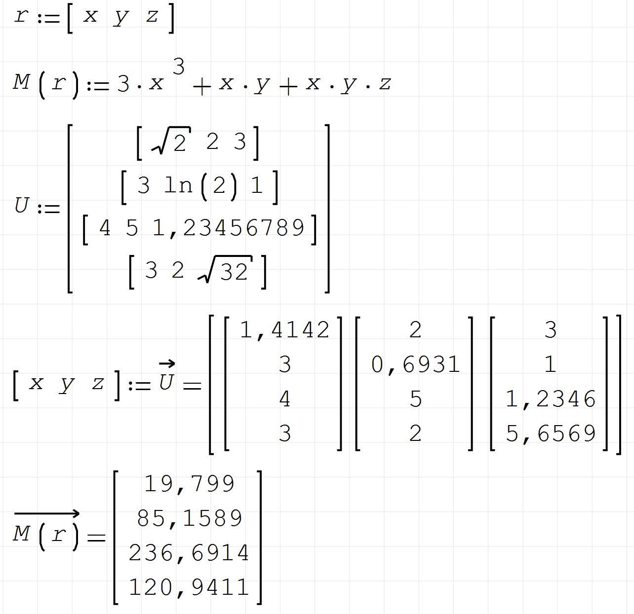

I take inspiration from Jean, but I use the Vectorize function and I forget the size of U
Show Spoiler
FunzioniVettori.sm (6.37 KiB) downloaded 1061 time(s).

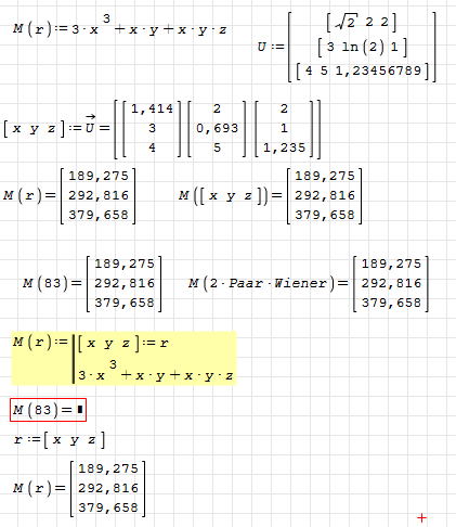

Pay attention! The definition of M(r) doesn't make much sense.
Superb Sergio ... added in the main document.

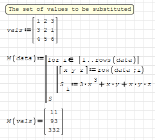

An algorithm can also be used.
It may be simpler by this way.
Worksheet1_algorithm.sm (4.69 KiB) downloaded 1102 time(s).

Nice implementation!!

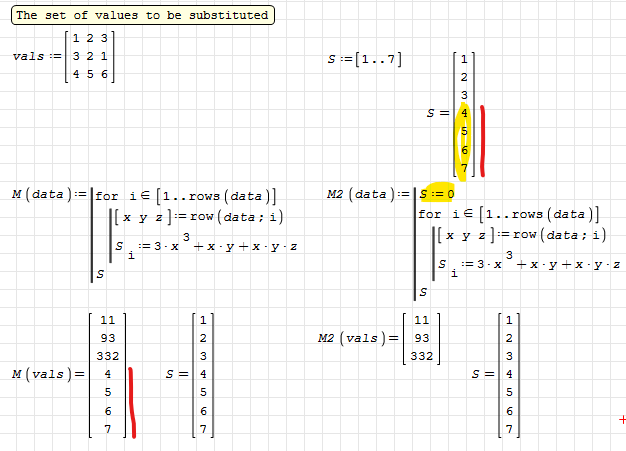

Just a question, does the S variable had to be declared and dimensioned previous to its use?
I will try the code asap!
Thank you !

You should always define variables used as arrays in function before assigning elements.
Worksheet1_algorithm.sm (8.04 KiB) downloaded 1102 time(s).

Just a question, does the S variable had to be declared and dimensioned previous to its use ?
No, it sets by itself within the for loop.
Wise to clear within the algo ... U:=0
That will avoid interaction with else U above document.
Algo style is an immense companion in Smath.
Personally, I use it as much as possible,
it enables the local command line.
Cheers ... Jean.
Maths algo style MATRIX in_extenso.sm (5.88 KiB) downloaded 1109 time(s).
MarB is dead right.
Array variables should be considered carefully if they will be redefined multiple times.
Or they can be undefined and named uniquely. I tend to name variables in functions this way.
You can find below how I would name your functions variables.
Pretends mess of misusage.
It isn't required but it is good practice. If the variable name already exists you might fall in some unexpected cases when the dimensions are different. In addition to the above suggestions, you can use also a Clear(S) as initializer.
