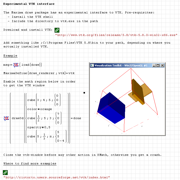

The Maxima draw package has an experimental interface to the VTK visualization toolkit. It provides high performance 3D rendering.
Objects and options are very similar to those of the Gnuplot interface in the commands Draw2D() and Draw3D().
The current state of the Maxima plugin allows you to play around with VTK. Some limitations apply:
- The interactive viewer is opened as a separate window (not embedded in the sheet)
- The Maxima plugin does not wait for the viewer to be closed but gives up after some short time.
- Any SMath action while the viewer is open can generate a crash.

#65 Posted: 2014/8/3 11:24:12
Thank you Martin with keeping this up
I just played a bit (see the picture, please). I suppose this will be improved and I wish you all the best of luck in your efforts.
In the case I did not do something wrong here, but it seems that my example produces additional gnuplot windows.
probavtk.sm (5.7 KiB) downloaded 1343 time(s).
#66 Posted: 2014/8/4 15:53:01
1,355 likes in 2,271 posts.
This is related to issue SS-189. Maxima is restarted and the plugin retries to execute the command. However, in the new Maxima process, the variable draw_renderer has the default value (gnuplot) instead of VTK.

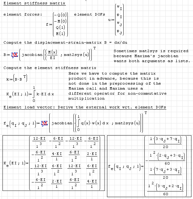

In the attached sheet you find the construction of the element stiffness matrix and the element load vector for a shear-stiff plane horizontal beam finite element as used in this example.
IVR 2017/1/26 19:02:00
