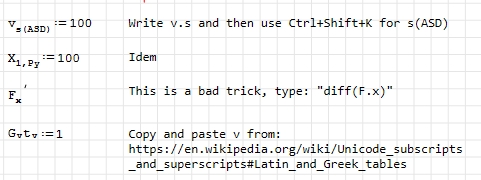

I generally like SMath better than Mathcad (especially since they went to the "Prime" version), and I've even found some things that SMath will do that Mathcad Prime won't. but in trying to replicate formulas from the American National Design Standard (NDS) for wood design, I am running into more and more examples of variable names and subscript characters used in the NDS publications that aren't allowed in SMath. The biggest advantage that Mathcad seems to have over SMath at this point is in formatting (their fonts in math regions seem more legible) and in allowing more variability in variable declarations (e.g. characters not allowed in SMath, or characters combined in ways not allowed in SMath). Are there any options for workarounds in SMath that I'm not aware of? I'm teaming up with another author to write a design guide for wood design, so the formatting is more critical in this published work than it would be for my normal calcs at the office. If it were just my own calcs, I'd just use alternate notation, but I'd like to match up as closely to the national standard's notation as possible when publishing a book related to it.
Below is an example of a variable used in wood shear wall calcs where 2 values for shear modulus (Gv) and thickness (tv) have been combined into 1 tabulated value of Gvtv with the "v" in subscript. SMath doesn't allow getting in and out of subscript entry in one variable definition, as far as I know.
The vs.asd entry below that is one that neither SMath or Mathcad will accept as NDS shows it, since NDS uses "s(ASD)" in the subscript, and neither program recognizes parentheses as part of a variable name, even in a subscript. So for that one, I may just have to use a period or underscore or some other alternate notation from what the published standard uses. Another case that I see used a lot in published engineering calcs is the use of a comma in a subscript, such as "P1,y" where the 1,y" would be in subscript. I don't think either Mathcad or SMath allow that, but it is a common notation from what I've seen.

The Fc⟂ entry is one I figured out I can insert from Windows Character Map, although it comes out somewhat tilted in SMath, like it's italicized.

#2 Posted: 2021/7/31 15:15:45
1,123 likes in 1,795 posts.
Hi Jason. Some notes.
SomeFormats.sm (3.89 KiB) downloaded 1090 time(s).
Jason McCool 2021/8/1 19:16:00, Erick Valentino 2021/10/1 19:27:00

Hi churichuro.
It comes from mathcad, I don't know from which version or even which one is valid. It is used to use characters that are usually operators in the definition of variable names. That is, to write things like "a/b" or "a+b" as variable names, or variables with spaces "a b", and some others cases.
I suppose that somewhere here it must be documented, but I don't know where. For instance, not here: https://smath.com/wiki/Keyboard%20shortcuts.ashx . The line describing it could be:
Ctrl+Shift+K - For type characters that usually insert operators.

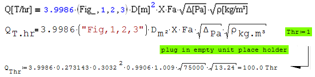

#8 Posted: 2021/8/1 11:38:15
... otherwise never use units in Engineering document.
#9 Posted: 2021/8/20 15:01:34
Ruben Sidranski
Ruben Sidranski
17 likes in 465 posts.
Been on this horse since MathSoft Forum . It can help to debug, but most of us use SMath/MathCAD because it handles the units for us.
I remember asking Andrey for "Ctrl+Shift+K" many years ago ... Maybe with the new NOTEBOOK feature, this may spur him to add it. I've been out of doing CALCS for a bit but I don't see it implemented yet.
EDIT: In the features area of the forum, request "Ctrl+Shift+K" feature from Mathcad

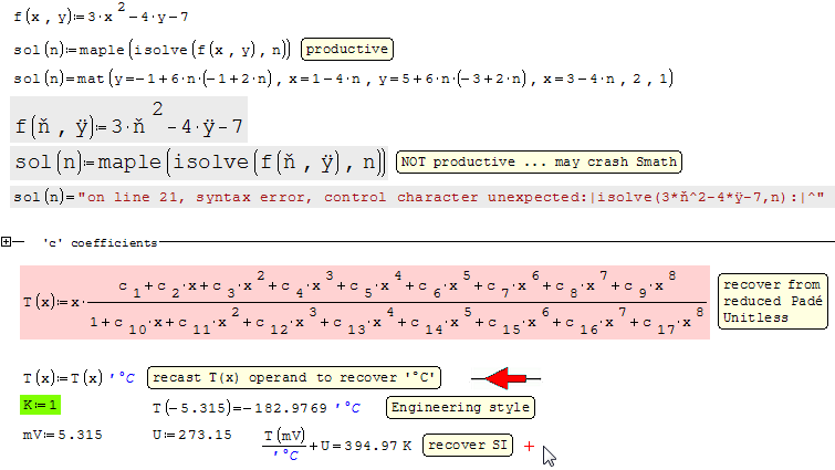

Adding on to this topic, I just came across something surprising that I can't get either Mathcad Prime or SMath to do: write a single dot or a "hat" (or caret, or circumflex accent) above a variable. This is really surprising given how common these symbols are in math from high school and college up to various engineering disciplines, and both programs exist to allow us to solve math in its symbolic "native language" as opposed to a bunch of obfuscated cell references in a spreadsheet. I've tried using the diacritical combining marks from Windows Character Map in both programs, and some of them work and some don't. I've looked through different fonts, and some, like Courier New, have more combined letters like u with a double dot or j with a caret, but I would really like to be able to match up my variables with the textbook examples for ease of debugging and for standardization for peer review. On a side note, Mathcad 15 would allow several of these characters. Any chance that this is possible in SMath with some workaround I'm not aware of, or that it could be someday? It seems like PTC really took a step backwards in going from Mathcad to Mathcad Prime in that there's a lot of things Prime can't do that Mathcad had always been able to do. This might be an area where SMath could be better than Mathcad Prime, for what it's worth.
Thanks!
Jason
#12 Posted: 2021/10/2 21:16:50
Smath, Mathcad ... are productive numerical CAS.
They are not gyzma decorative creators at will.

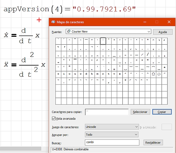

Try to search "comb" or "combi" in charmap, copy and paste in SMath. If doesn't work, try to open the attached SMath file, if your system doesn't fully support unicode maybe you can't see this, like what happen in my virtual windows 7.
OverDot.sm (2.65 KiB) downloaded 1115 time(s).
Addendum: Apparently no character that has "accent" in its name can be combined with consonants. This is à ä â but x` x¨ x ^.
sergio 2021/10/3 13:01:00, Jason McCool 2021/10/3 11:38:00
Thanks, Alvaro. That explains the mystery of the not being able to combine F^ and k^ would both be consonants. Interestingly, while I can get x to combine with a single dot above or a double dot above, the vowel "u" will only combine with a double dot and not a single dot in any of the fonts I've tried. And I have been using the "Combining Diacritical Marks" as it's labeled on my English system, same as your "combi". It does make me wonder what my various physics and engineering mechanics books over the years were using to write out their equations since they commonly used the notation of i,j,k with the circumflex accent (hat) over them to denote unit vectors in the x,y, and z axes. I guess maybe the publisher used a custom font that had those symbols in it.
