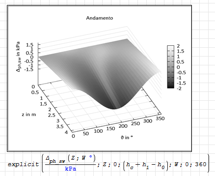

I've got a problem with a 3D plot function.
The function is very simple but i'm not able to find the correct syntax for plot it.
Someone can kindly help me with some advising?
Thancks in advance, i attacched below the Smath reference file where i had higlighted with an arrow the function.

For instructions on Maxima plots see https://doi.org/10.25933/opus4-2949
Note that the dummy variables need to be undefined in the sheet.

Thancks so much for your answer!!!!
I'm very gratefull!
I'm very gratefull!
Very easy to get the two circles ... one being shifted.
Tip about X_Y plot ... as soon as you open, give a title.
Next manipulation, click on title.
That technique will save from freaking X,Y ranges.
Jean.

WroteI've got a problem with a 3D plot function.
The document from Martin does not work for me.
At this point of the project, if you can attach the matrix,
I may try to render the gray image in RGB.
I have the RGB mapping codes associated with the vectorise code.
Not so sure ... your matrix is huge 360 cols !
