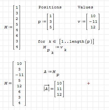

Is it possible to assign specific values to specific elements and take the absolute value of other specific elements of a large vector with say 400 elements? I have tried for loops and if structure to no avail. I assume I just still don't understand the syntax in SMath.
#2 Posted: 2019/3/8 03:48:51
1,123 likes in 1,795 posts.
Hi. Something like this?
vector.sm (6.15 KiB) downloaded 1045 time(s).

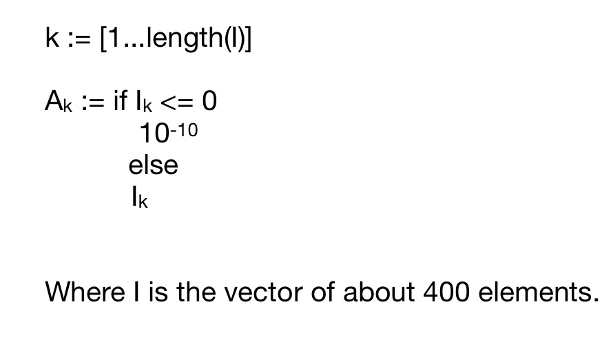

What if I don’t know the positions that need changing ahead of time? In my vector of about 400 elements, some values are negative. I would like to change only those values to about 10^-10 or take their absolute value and leave all the other elements of the vector unchanged because I plan to plot the vector on a log-log plot.
This is quite easy to do in Mathcad, but it seems SMath doesn’t have the same capability. When I try to test on a value of an element using SMath’s if statement to see if that vector element needs changing I get syntax errors in SMath.
I was hoping to use something like this, but it doesn’t work.
k := [1...length(I)]
A[k := if I[k<= 0
10^-10
else
I[k
Where I is the vector of about 400 elements
Forgive the [ since the forum doesn’t allow subcripts or less than or equal. I am on my iPad now and the forum also does not allow uploading jpg from my photos.

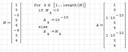

This?
vector.sm (4.61 KiB) downloaded 1003 time(s).
#6 Posted: 2019/3/8 04:54:10
RegCurry
RegCurry
0 likes in 57 posts.
Thanks much. I thought I tried that in using a program line, but I guess I had some typo.
Thanks again!

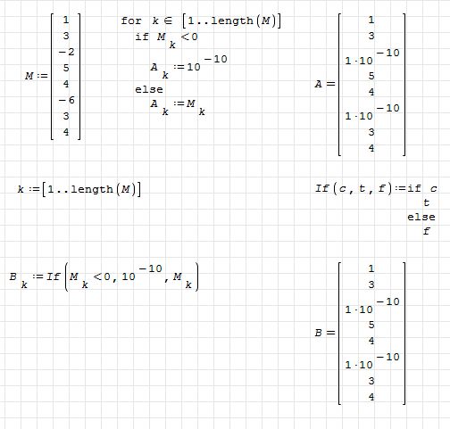

Hi. The method in your picture, using range vectors, fails because 'if' have an special evaluation method, For instance, the true or false parts are evaluated only if the condition results in true or false, respectively.
This method is a workaround, but isn't very efficient.
vector.sm (7.5 KiB) downloaded 1008 time(s).

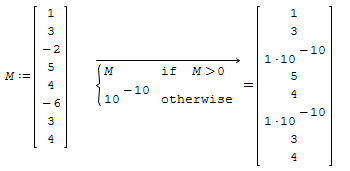

vector(1).sm (3.9 KiB) downloaded 1018 time(s).
sergio 2019/3/8 12:47:00, NDTM Amarasekera 2019/3/8 13:12:00, frapuano 2019/3/8 18:02:00
