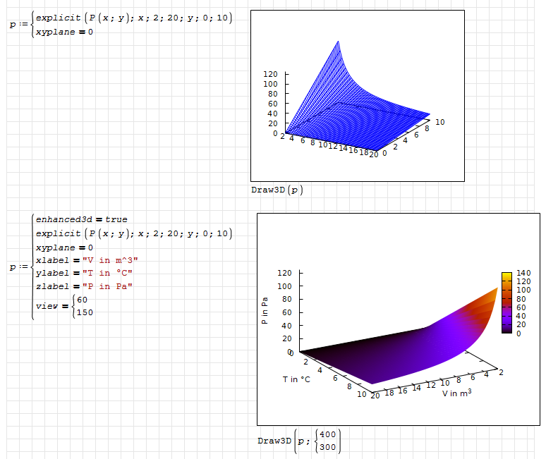

For my Physical Chemistry lectures I am adopting MathCAD 8th sheets attached to the Atkins and de Paula, 7th edition textbook, to the recent SMath Studio. For 3D plots I am applying plugin "3D Plot Region (Chart3DLib)" it works good except saving formatted plots. Have you got any idea how to resolve the problem.
The SMath sheet and PDF screen attached.

The given solution controls the orientation by the view parameters.
Yet there is a so called Maxima Draw3D region, where interactive rotation is possible, at the price of slightly less stability (the region might freeze).

WroteFor 3D plots I am applyingplugin "3D Plot Region (Chart3DLi" it works good except saving formatted plots. Have you got any idea how to resolve the problem.
Considered a bug, reported, never solved ... plugin as is
can't mesh, does not save setting => useless.
