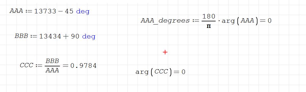

WroteThankyou, but, sorry... I must be doing something wrong here?
I can't understand why I'm getting zero values, perhaps I'm entering the angles incorrectly?
Indeed, you do.
You are adding radians to degrees not real and imaginary components.
you would need to make a function to convert polar representation to cartesian representation and back.
