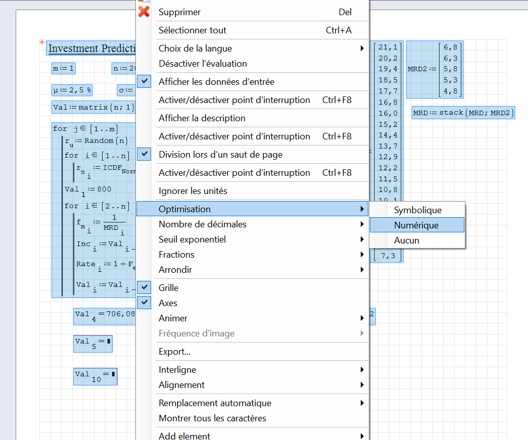

Try to put "numerical optimisation" over your formulas.

Hello Mike,

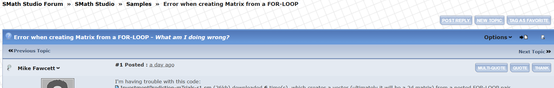

3. In order to answer on a post, look upside of the first topic and press the button "Post Reply", as here:
4. As about “optimization mode”, you cans specify your option for the whole program, by selecting (Ctrl+ A) all the content and then right click the mouse and precise yous option, as here:

Ioan
