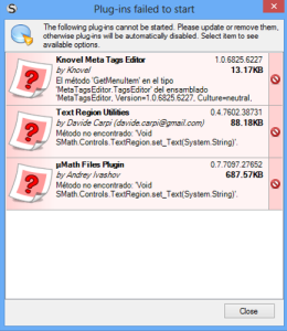

Hello
The following plugins crash in Smath Studio 0.99.7679
Carlos

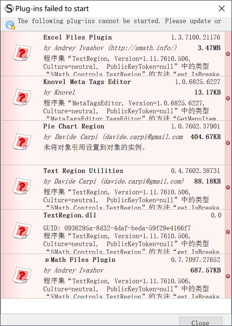

I have the similar issue:

But the Text Region Utilities plugin keeps crashing
Carlos

mMath Files and Knovel Meta Tags Editor plug-ins fixed.
When installing them through plugin manager, both of them shows "plugin installation fails"
#9 Posted: 2021/1/11 10:00:52
2,340 likes in 4,041 posts.
Looking at the screens hot you provided it seems that you have plug-ins installed by manual copy of dll files.
You need to delete such plug-ins first and then install then from Extension Manager.

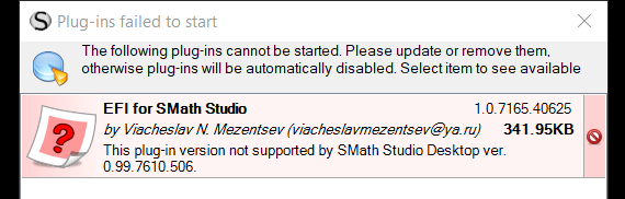

UNI's EFI plugin is crashing too.
My new portable install has no plugins at the moment
Should I remove it per 0.99.7610 is available
Strange. Just checked EFI plug-in - it loaded correctly in my SMath Studio installation.
As you see from the screenshot above, I'm using version 7610 (portable version). I uninstalled the plugin and reinstalled. The install went well and no errors. However, once I restart SMath, the error pops back up.
Could it be a portable version issue?
