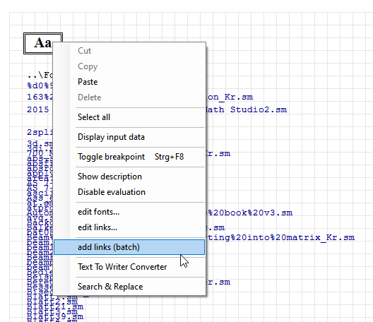

The interactive handbook is an example of such a document. In the early years this approach required editing of the xml contents of the sm files, based on inspection of Andrey's math reference book.
Davide has provided the Text region utilities plugin, which provides means to edit these links from within SMath Studio. The "toolbox" also provides batch generation of links to all files in a given directory. Unfortunately, this doesn't work any more in recent SMath versions.
At least in build 7579 it worked.
The link text can be generated based on file name (as in the screen shot) or based on title or description from the metadata (File> Properties)

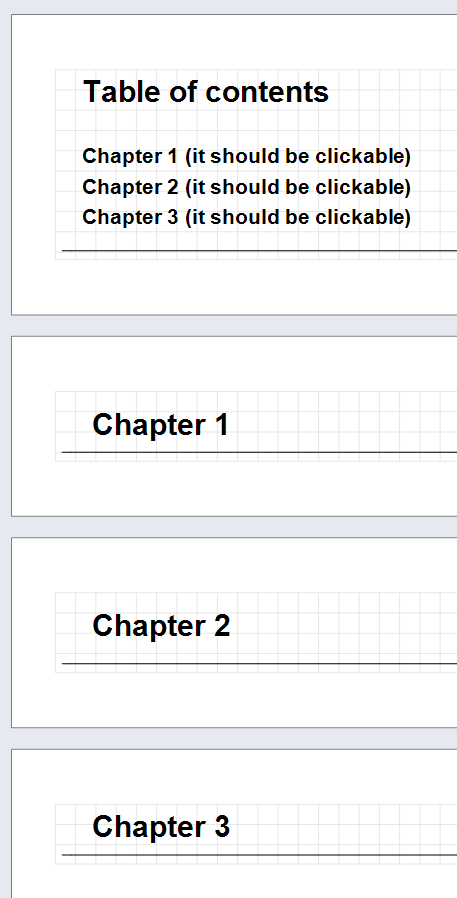

Hi Jean, thank you for your reply, but I am not sure I understood it. Maybe I wasn't clear, I have attached an image of what I pretend.

WroteComplex documents can be split into individual sm files which can be cross-referenced by text regions with active links.

WroteHi Jean, thank you for your reply, but I am not sure I understood it. Maybe I wasn't clear, I have attached an image of what I pretend.
Attach your 3 Chapters as 3 clean images from Word.
I will make them brute force accessible.
Cheers ... Jean.

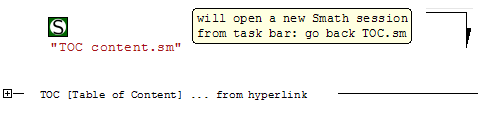

In the mean time you have Go to page
from the coded TOC, you can survive/access ▄ this demo.
Very easy to sanity QA my for 4 Clients from remote.
BTW, the Mathsoft page hyperlink was tested only, never used
in the Mathsoft Collaboratory over 10 years I shared.
Cheers, best ... Jean.
TOC [4 Clients Model].sm (205.29 KiB) downloaded 574 time(s).
