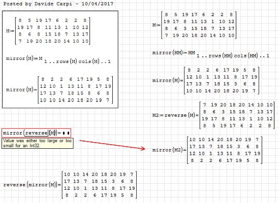

even simpler
2017-04-10 17_06_46-SMath Studio - [Utilities%20Matrix%20Rotate%20Quadrant.sm_].png

Why this happens with attached worksheet?
Mirror_Problem.sm (20.51 KiB) downloaded 1217 time(s).

#5 Posted: 2017/4/10 18:43:24
The two red regions created "Unknown error".
The algorithmic chain fails.
Mirror_Problem.sm (20.51 KiB) downloaded 1201 time(s).

#6 Posted: 2017/4/11 06:22:38
1,443 likes in 2,935 posts.
You found a bug in el(), thank you!
added in BTS [SS-2438]

Hello Davide,
IMHO, the case reported by collab NDTMA is not a bug.
Simply an instance of "shadow in the context" [Mathematica].
Similar broken algorithmic links have been encountered in Mathcad.
We can't play much with the "vector/matrix" codes.
Here is a similar example in the attached.
Cheers, Jean
