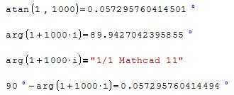

It took me a great deal of effort to figure out why the complex atan function returns the wrong result. I compared it with Mathcad until I realized that it was working partially after I entered 90-atan(a,b)*180/PI. This at least matched the Mathcad result until -90 degrees was reached. Beyond it would require a different combination.

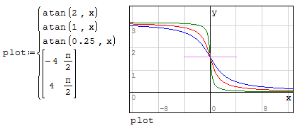

That's not true ... atan(2) from f(x) menu.
complex atan = atan(2)
Nothing wrong Smath native code atan(2)
#6 Posted: 2020/3/30 18:22:03

I understand. Also last night after I got off teleworking I investigated the issue a bit further. I was wrong, the issue is not Zedgraph, it is how Smath Studio interprets atan2. I compared that with Matlab and Wolfram and both interpret it the same way as Smath Studio. Mathcad is the outlier here by following the Electronics Engineering definition of complex arctangents. Too bad but I believe this difference can be overcome with writing a programming function in Smath Studio to do that. I am not the best with these programming structures, my mind works a little different but hopefully will be able to do that on my own. It might take some time, but that is OK.

Oh ! my friend: calm down coding Smath/Mathcad
atan(2) was controversed in Mathcad up to 11.
In fact, Smath that is more largely based on universal libraries
often detects wrong MCD code, though not wrong within itself.
example: UnitVector(x):= x/|x|... nonsense as such coded Smath
Smath... UnitVector(x):x/norme(x) ... universal compliance.
UnitVector was detected while solving Quaternions.
there are more occurences [3D axes system].
