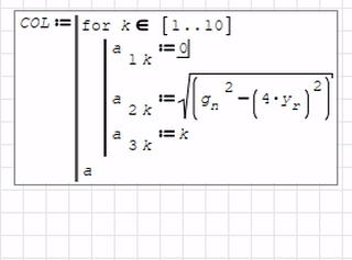

hi can anybody please explain why the following does not work, and how I need to change it.............
many thanks
#2 Posted: 2021/5/24 19:19:39
580 likes in 1,349 posts.
many thanks
No problem here. You have misspelled the function.
The equality for 3*4 or 4*k is next to matrix element.
It has to be next to matrix, whole of it.
COL_FOR.sm (4.49 KiB) downloaded 652 time(s).

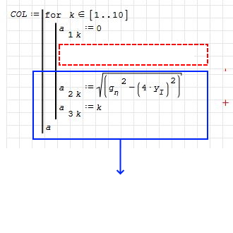

Folks, I have another query please and am grateful for help.
As per diagram below, how do I move several lines down and create space for another equation inside my "for" loop.
#7 Posted: 2021/5/25 20:22:23
Use your arguments separator for this.
This works also for vectors but not for matrices.

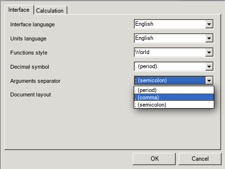

thank you, but can you please clarify what exactly is the "arguments separator" ?
#10 Posted: 2021/5/25 21:12:44
It depends on your setting.
Its setting is under Tools > Options.
I use semicolon, default is comma I guess.

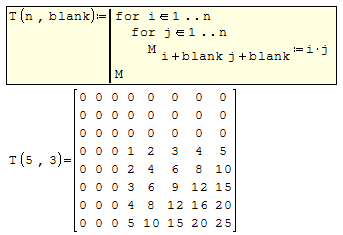

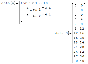

#11 Posted: 2021/5/25 21:22:37
how do I move several lines/cols down/right and create space

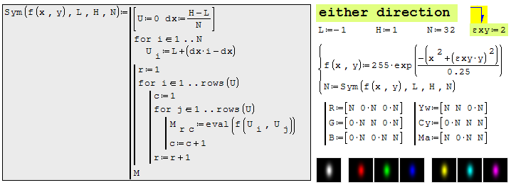

Page12 Ravel Matrix.sm (9.46 KiB) downloaded 708 time(s).
