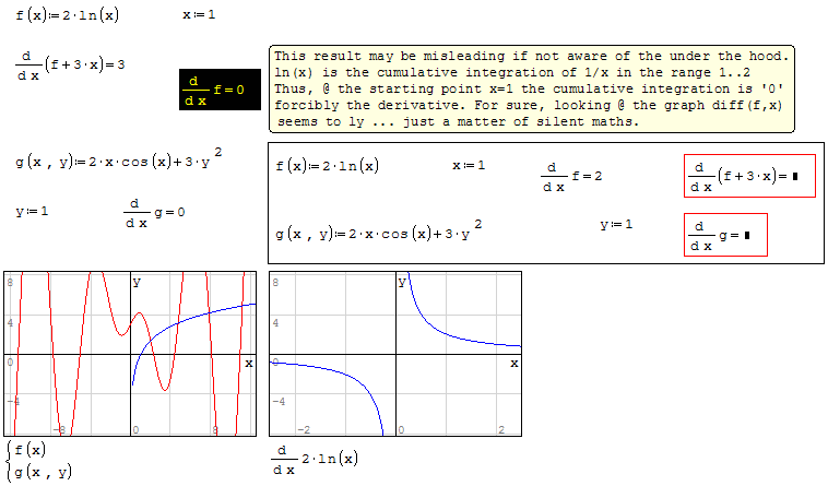

Hello Alvaro,
I have the impression that numerical derivative and integration issues (especially with units) will be here on the Forum for ever . I wish I was wrong.
The analytical attempts with Maple or Maxima will fail here. We are forced to use numerical solvers or functions here. Here is the solution (not straight forward though) only in SMath.
I tried Gradient.CD() from NumericalSolvers plugin, but I failed.

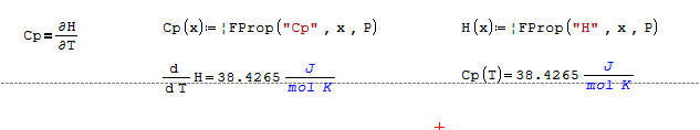

Aside smath issues, you can use the coolprop derivatives syntax (units not handled here, wrapper stuff to check)

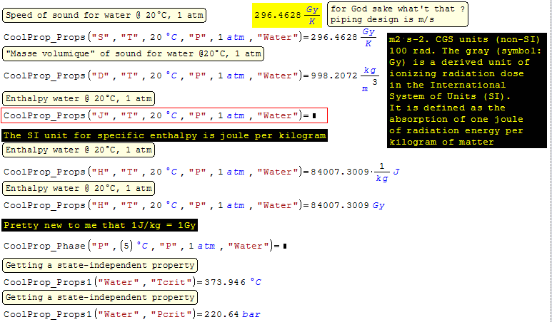

#6 Posted: 2018/1/29 03:11:21
No comment ... just learn that fluid speed in piping
is no more m/s since century, rather Gy/K ... does is
run faster/slower/fly out of pipe/spits out $$$

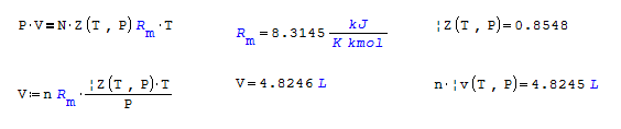

Hi Jean. Good to read you. The "project" is just write the classical thermodynamics formulas and check them numerically, like

#10 Posted: 2018/1/29 16:07:28
These two turned red in 6179, quite puzzling.
Are they red in your 6484 ? if YES => Oh !
