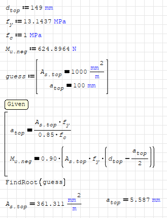

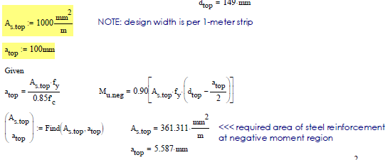

Is there any way that this could be replicated? I've been using solved symbolically and FindRoot but if there is another intuitive go around would be appreciated. Yellow marked were initial values for finding the roots.

There is Mathcad Block similar to this.
Here is the answer to your question.
Actually there is no intuitive here, it is just habits.
FindRoot(), roots(), solve(), al_nleqsolve(), etc are easier to me.
Because I am more used to work with them.
You possibly will be more comfortable to use Mathcad Block.
Because you used Given,Find functions for long.
mathcad_block.sm (6.75 KiB) downloaded 1539 time(s).

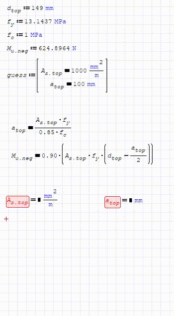

Also, one big thing. I don't know how the Mathcad block works.
I will assume you have installed Mathcad Toolbox plugin.
Its requirements works similar to FindRoot() or other solvers.
When you add block and click on it a blueish rectangle area appears.
Your unknown functions has to be inside of that area.
And you need to write your solver with start points/guesses to its handler.
Here let me show it with a gif explains on your question.
More info can be found in Extensions page link below.
Mathcad Block has very detailed examples on its own page.
https://en.smath.com/forum/yaf_postst726_Mathcad-Toolbox.aspx
Thanks again, finally did it.

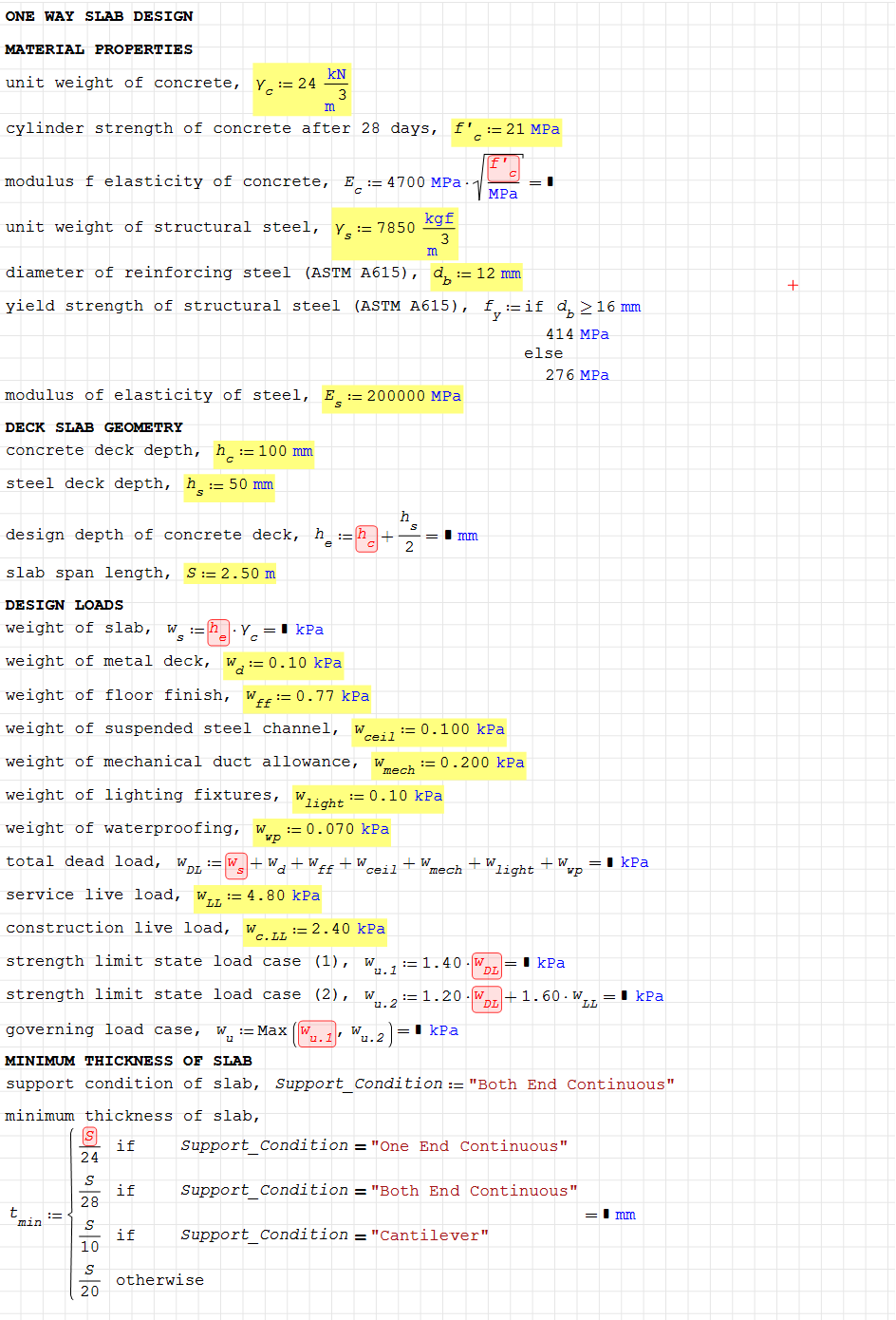

I have a few more questions for another thread I guess, but I'll try here first. I don't know if I you'll see this but I'll try anyway.
(1) Where does that cream-colored rounded rectangles come from? Is that a text region, a special function? I tried to replicate that days ago but I went blank how to.
(2) May you look at the image below. I generally use: [text goes here, variable:=1mm] all in the same line and it comes blank. This was not available in Mathcad and was actually a good thing for me since I possibly can't misplace their descriptors whenever I'm moving things,especially variable, around. Problem is this one makes an error for me. Is what I'm doing a bad practice?
