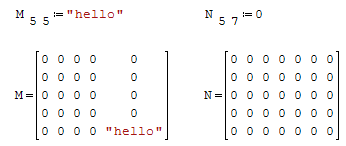

#2 Posted: 2017/2/3 16:01:09
ZeroMatrix: like this
But it is not. If I insert M(0) is length matrix 1, but I need length matrix 0

#7 Posted: 2017/2/3 18:51:10
But it is not.
A matrix of order zero is a "zero matrix"
If you want it rectangular from the fx menu
'Ones(3,5)' ,,,, then of any value: *1.23456789=
