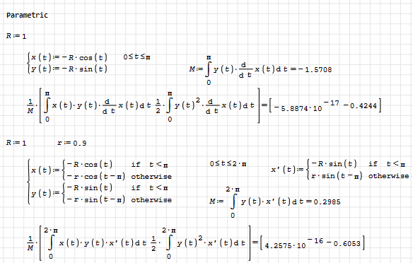

Help me please - see attach
Gravity-Center-n-points.sm (331.61 KiB) downloaded 814 time(s).

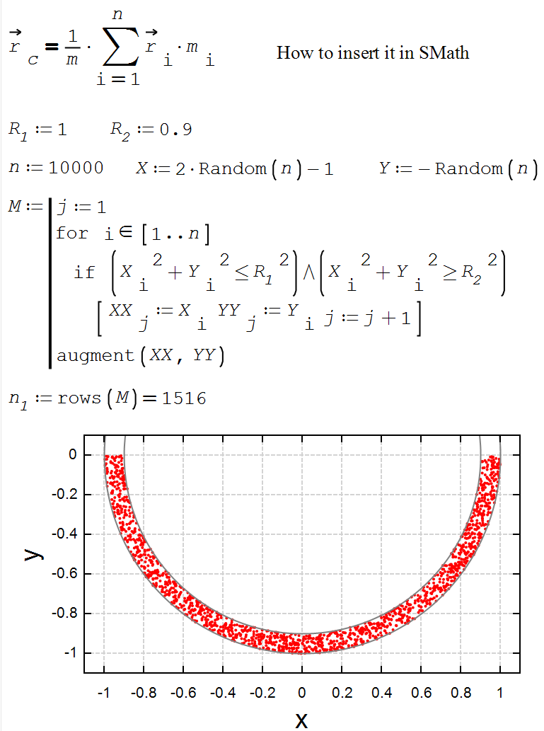

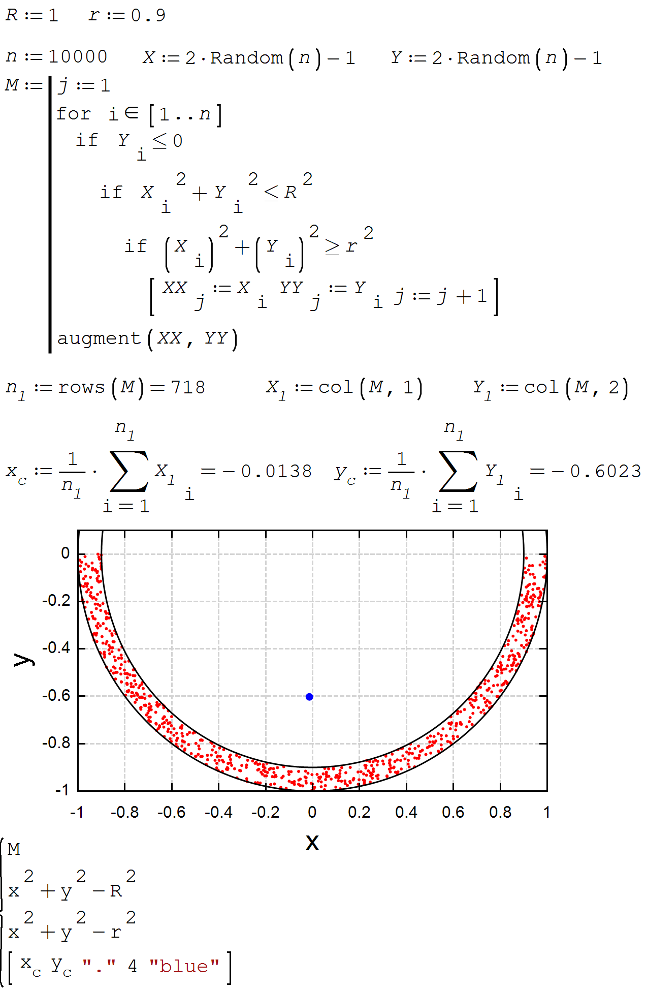

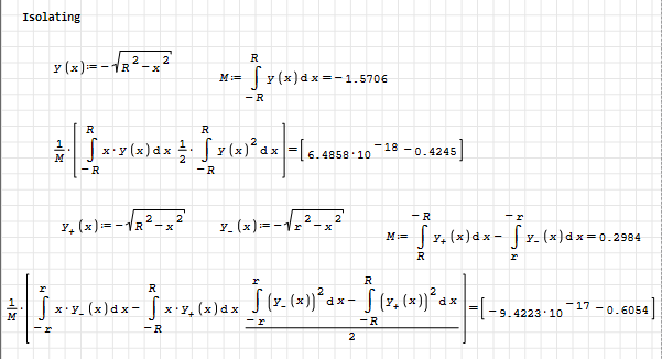

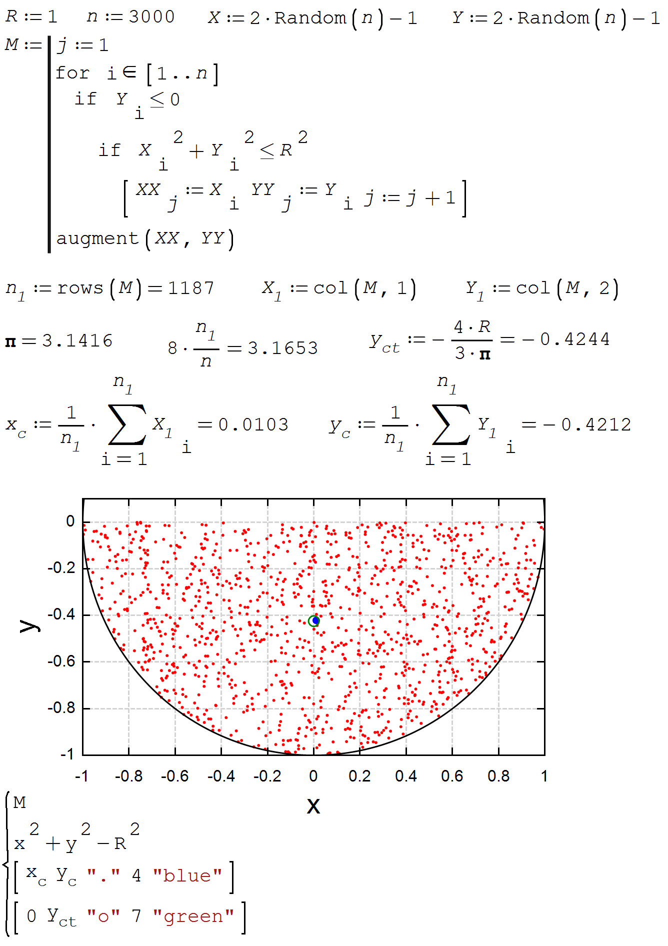

Solutions for same mass of points. OK?
Gravity-Center.sm (14 KiB) downloaded 878 time(s).
One test

For comparison, the true value for your semi-annulus is given by 4*Reff/(3pi),
where Reff = ( (R-r)^2 + 3R*r )/(R+r).
With R=1 and r = 0.9 this is 0.60534722.

Oh, I see. The intention is to use statistical functions. This vectorized version can replicate more or less the results, but SMath is very slow for large vectors.
mass-center-statics.sm (52.11 KiB) downloaded 844 time(s).
mass-center-statics.pdf (307.24 KiB) downloaded 434 time(s).
