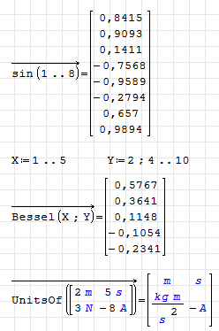

(Last line with error is just to demonstrate that without vectorize(), the error is the same as with vectorize(), so seems that vectorize() has no effect)
I suspect that the problem is because the Bessel function is defined in a IPluginLowLevelEvaluation plugin (StatisticalTools by Davide). This interface is afaik the most used among SMath plugin writers, so it would be desirable to extend vectorize() to work correctly with that kind of plugins.
Please excuse me if my reasoning is incorrect, and the real cause is something other.

"Bessel" but which Bessel ?
In Smath 5346, there are quite a few built-in "Bessel" from menu f(x).
I understand what you are attempting, give me a day or two.
For what I can see, vectorising is not the best approach.
Bessel mwbesselj.sm (8.05 KiB) downloaded 728 time(s).

Hello.
Everything you said is correct. I've just improved vectorize function to support functions from plug-ins.
Thank you!

#6 Posted: 2016/3/30 14:55:42
Which Bessel ? There are 34 "Bessel functions"
Your Bessel is typically a vector of 5*5 = 25 elements.
Still something not correct.

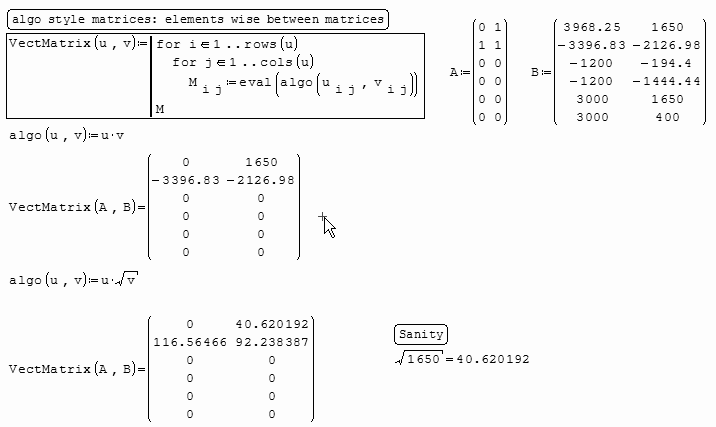

Hi all, did not want to open a new vectorize() topic so posting my question here. From what I know about vectorize is that in order for it to evaluate you need to satisfy the following:
1. Arguments must be two matrices with matching dimensions
2. Operator must be applicable to scalar variables
If the above is correct, I might have detected an odd behaviour.
And as a side note: Andrey, please do not get discouraged by all the recent controversy surrounding vectorize(). It is a very useful function. My only suggestion would be to make sure that it consistently follows a simple list of logical rules, and to make this list available in the SMath release notes / documentation.
http://smath.info/cloud/sheet/xVqGb4rhZq
vectorize1.sm (9.94 KiB) downloaded 709 time(s).

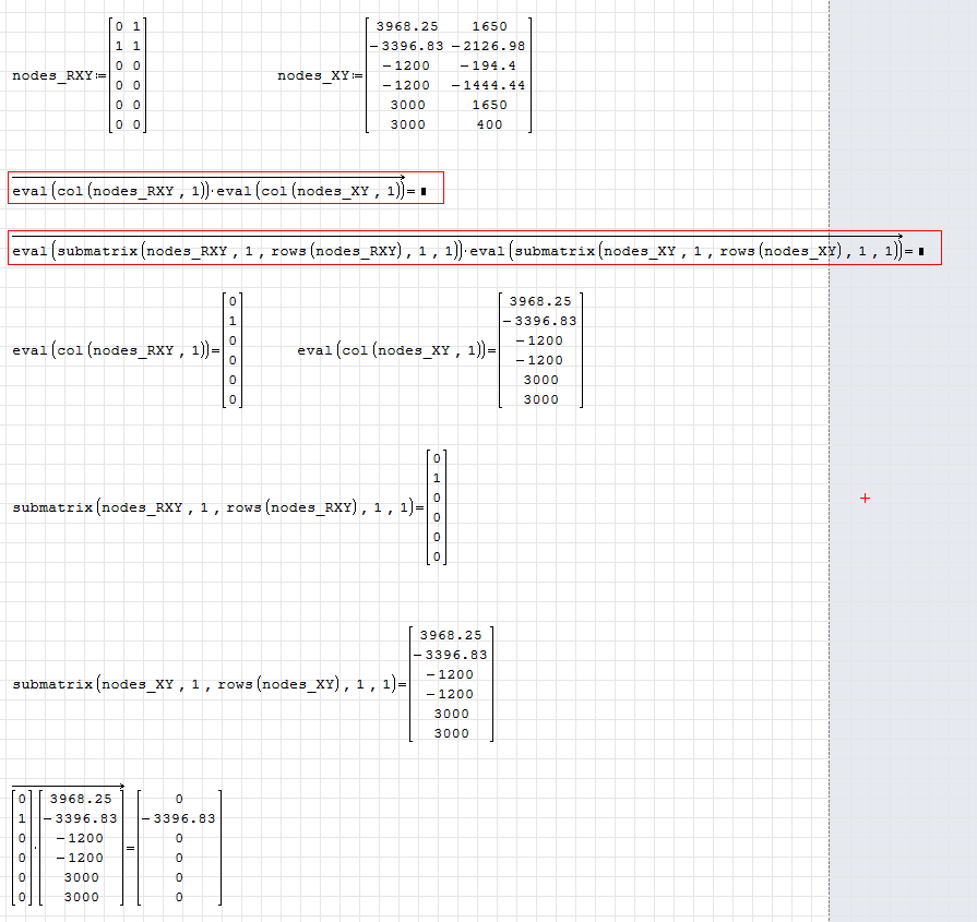

#8 Posted: 2016/4/2 17:06:38
You didn't test completely ... Ah !

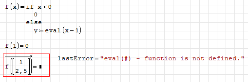

Well, then I will add here, too
This minimal example is completely made up for demonstration only. No meaning in it other than to demonstrate a problem.
Here three pieces are relevant: if(), assignment of y, and eval(). Without any of these, it works.
