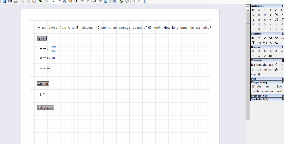

Hello, I would like to do simple calculations with SMath, transform formulas and then use the numerical values. Is that possible? I am new to SMath and unfortunately I didn't make it.
Thanks for the help

#3 Posted: 2019/12/31 05:48:21
Max12
Max12
0 likes in 3 posts.
Hi Carlos! Thanks for the quick response. Your document works very well.
I tried to copy it, but unfortunately I failed.
I have created an animation of my work steps.
Maybe you or someone else can help me where I make mistakes.
Thank you very much and a happy new year.
Max
#4 Posted: 2019/12/31 06:42:01
Max12
Max12
0 likes in 3 posts.
I've come to understand it by now. The unit is removed by multiplication.
It works now.
Greetings
Max
