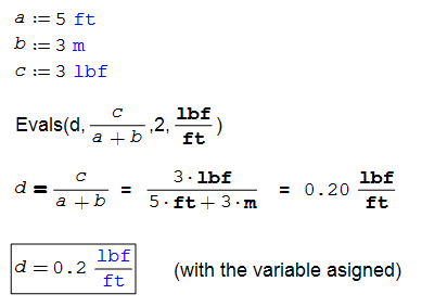

Alvaro 2023/2/22 19:11:00
Hi Kenny, thanks. It is absolutely true, I completely forgot that the purpose is necessarily not only to show the calculation, but to use it later. Well, though, at least it's not a 3-order-of-magnitude error, like the one I recently had.
This version saves in the first argument the numerical value of the evaluated formula. The rest of the code and the behavior stays the same.

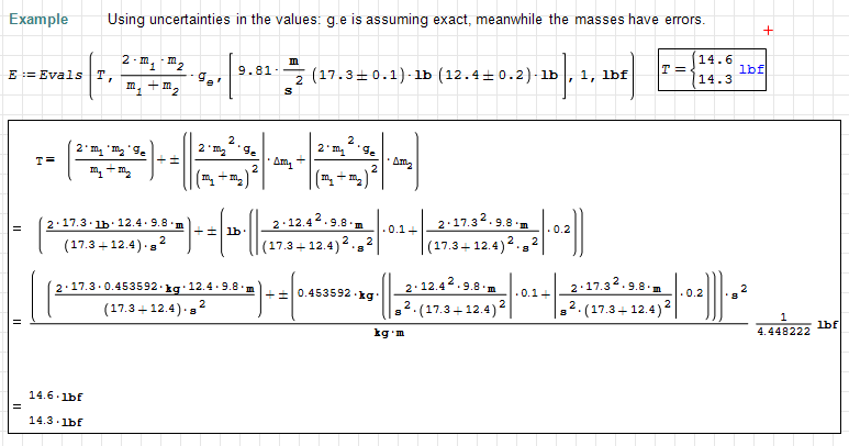

Version with uncertainties calculations added.
EvalsWithErr.sm (90.11 KiB) downloaded 1549 time(s).
EvalsWithErr.pdf (215 KiB) downloaded 888 time(s).

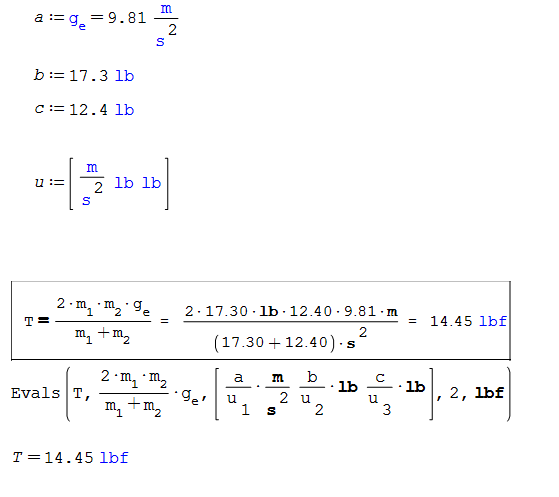

Hi. This could be a first approach.

churichuro 2023/7/4 14:57:00
So I honestly think the original input was fine. Defining variables in a mathcad window is a bit annoying.
The only change I think is needed, but seems to be very hard or impossible, it to define the variables, used in the formula, outside of the evals function.
The best I can come up with requires you to define a second time what units are used for each variable used.
As you can see the variables are defined as any other variable in a calculation sheet and can be used in other formulas.
There is a vector that lists the units for each variable again. This is used to remove the unit when used in the Evals() function.
It seems like there is no way to do this without manually specifying the unit because there is no way to convert the variable exactly as defined into a string, you need to divide out the unit to keep the same numerical value. So there is no way to take the b:=17.3 lb and convert that definition into a string exactly as I show it. It would be nice if this was automatic, but I don't this is possible with how SMath is programed.
A note is that the first step in the substitution seems to reduce the units automatically. It would be nice to just show the initial substitution without any simplification or elimination of units in this first step.
I also changed the way the final unit is shown, so that it matches the blue color of other units.

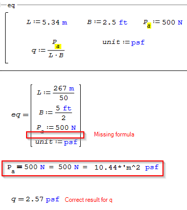

Hi Alvaro,
I've been looking into this concept again and I was hoping you could help me with some ideas/issues.
As it seems, the equation written within the Evals() function has to be with a,b,c.. or m1,m2,m3.. so alphabetical or numerical order, and this order matches the order of the listed values within Evals() as well.
![2024-05-23 11_45_40-SMath Solver - [EvalsWithErr with modifications.sm_].png](/zh-Hans-CN/files/Download/p3xYbh/2024-05-23-11_45_40-SMath-Solver---[EvalsWithErr-with-modifications.sm_].png)
There seems to a couple of issues with the order in which values are shown in the original equation vs. the later substitution steps, as well as how the units are shown for the substitution.
So here is what I envision as working well.
We can list variables as we normally do, and they can have any variable name, not just a,b,c or m1,m2,m3.
The Evals() function will require to specify the formula with the same variables you previously listed. Maybe listing the formula and the variables is enough and we don't need to list the variables again?
Then you need to specify how many decimal places you need, but it would be nice to not have trailing zeros so that substituted values look the same as previously listed.
Then we can specify the final unit we want for the result.
We don't need to show any steps and the substitution can be only a visual, the evaluation can be done like normal in the background and simply assigned to the variable listed.
![2024-05-23 12_17_11-SMath Solver - [EvalsWithErr with modifications.sm_].png](/zh-Hans-CN/files/Download/zPhTZe/2024-05-23-12_17_11-SMath-Solver---[EvalsWithErr-with-modifications.sm_].png)
Do you think something like this can be possible?

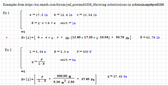

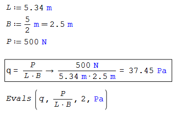

Hi. Something like this? (Examples at the end)

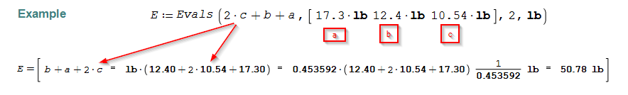

Hi Alvaro,
That is a start, but I still have some questions/clarifications.
Is there no way to define the variables outside of the MathCAD region?
In the original Evals(), both the question and the output unit were defined within the Evals() function, this is fine.
Any way to just show the unit after each value instead of showing the units grouped together?
In ne we have lb outside parenthesis, and in the other it is showing m^2 instead of two m units.
Also, is the order not controllable? We specified 2c+b+a, but get b+a+2c.

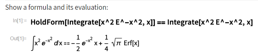

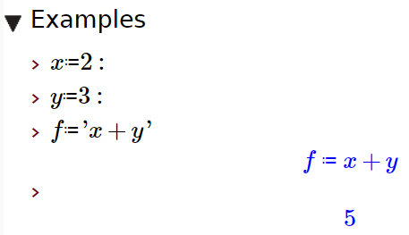

Hi. Mathcad solve block is the only way that I know about preventing evaluation. I don't see how do anything else, without something like the Mathematica's Hold or maple's uneval functions:
From https://www.maplesoft.com/support/help/maple/view.aspx?path=uneval
From https://reference.wolfram.com/language/ref/HoldForm.html

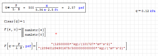

Sadly, this is the main issue.
Everything is fine for default units, but if anything is not in default, it is immediately converted, and the value as displayed is lost.

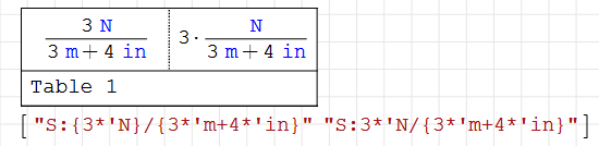

![2024-05-24 00_32_39-SMath Solver - [Worksheet1_].png](/zh-Hans-CN/files/Download/BgSNYY/2024-05-24-00_32_39-SMath-Solver---[Worksheet1_].png)
There seems to be no way other than the MathCAD region to do this at the moment.

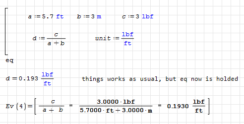

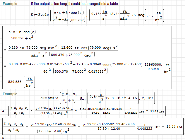

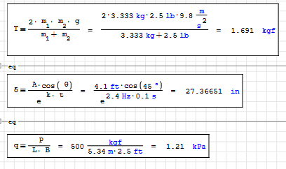

Another option (Version 3)
Evals v3.sm (62.34 KiB) downloaded 1518 time(s).
Evals v3.pdf (159.16 KiB) downloaded 959 time(s).

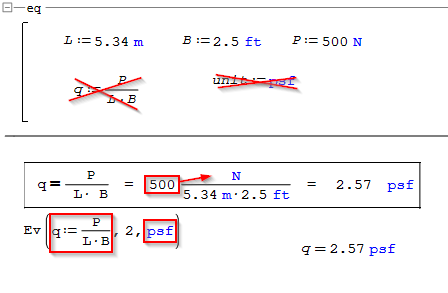

This is better, actually not bad at all.
Can you make it so that the formula is input directly into Ev() along with the output unit?
That way eq only contains the variables, since this part won't be hidden.
The Ev() function will be hidden in a table region to clean it up nice.
![2024-05-26 01_29_17-SMath Solver - [Evals v3.sm_].png](/zh-Hans-CN/files/Download/yBTbcS/2024-05-26-01_29_17-SMath-Solver---[Evals-v3.sm_].png)
Also, any way to get 500 up on top next to unit?
I’m confused because on your original Evals() function everything was input into the Evals() function. We can’t have the variables listed in the MathCAD block and the rest like it was before?
![2024-05-26 21_30_42-SMath Solver - [Evals v3.sm_].png](/zh-Hans-CN/files/Download/XVGSSB/2024-05-26-21_30_42-SMath-Solver---[Evals-v3.sm_].png)
![2024-05-29 17_49_58-SMath Solver - [Worksheet2_].png](/zh-Hans-CN/files/Download/aW5E3n/2024-05-29-17_49_58-SMath-Solver---[Worksheet2_].png)
