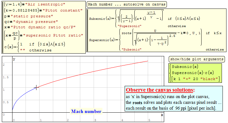

It's not Smath that saves as *.PDF, rather the virtual PDF installed
My system does everything as demanded [except singing a song].
Smath 6179, Win 7 1.66GHz, 10.1"
Freeware: Adobe reader, IrfanView, WinGrab + + +
IrfanView is a MUST to read documents that Windows can't.
Mach is the Smath work sheet captured WinGrab, saved *.PNG WinGrab.
WinGrab is the top best *.PNG for images that have lot colors.
It does not apply to a math document, but from other image creator.
Doublet from virtual CutePDF ... 1/1 Smath work sheet.
