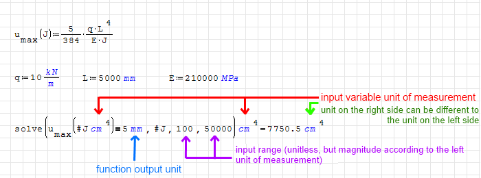

Actually I think the simplest way it's to insert units inside the "expression" argument of solve() (see the attachment)
regards,
w3b5urf3r

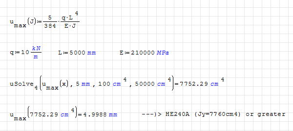

snippet updated!
now there are [MATH]uSolve.2(#)[/MATH] and [MATH]uSolve.4(#)[/MATH] to reproduce [MATH]solve(2)[/MATH] and [MATH]solve(4)[/MATH] with units
see the attachment for the usage
regards,
w3b5urf3r

Hi kilele
This snippet is a "little workaround" so have some limitations:
- [MATH]uSolve.2(#)[/MATH] and [MATH]uSolve.4(#)[/MATH] first argument must be a single-argument function
- [MATH]uSolve.2(#)[/MATH] need the third argument to know the unit of measurement of function argument
however, taking care of these limitations, inside the function you can use multiple units and the input and output units may be different (see the attachment, introduced in the new unit_examples.sm re-attached in the post above)

The third parameter provide only the kind of unit (mass,length,force,pressure,etc..), the desired output unit must be set in the right side, after the evaluation (see the attachment)
regards,
w3b5urf3r
