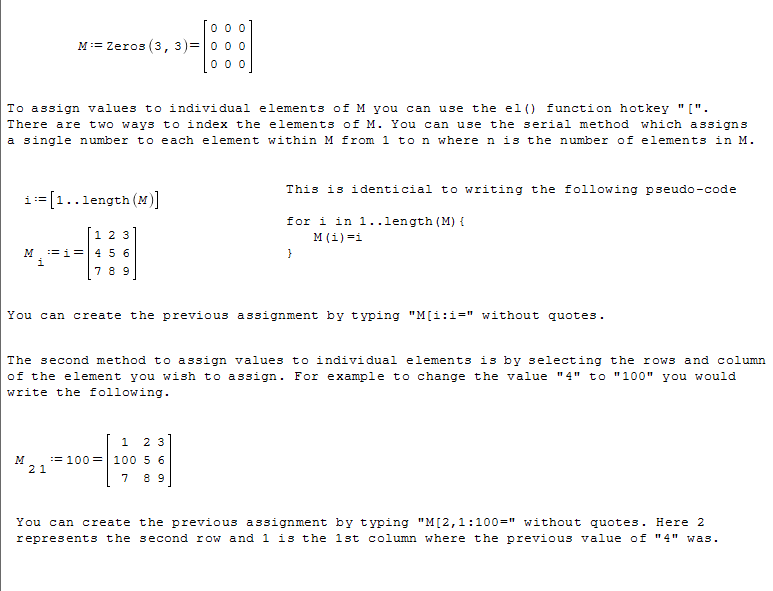

QuoteFor example, it would be useful to be able to matrix element assignemnts instead of always clicking the matrix panel to the right.
Please take a look at the following file.
Matrix Example.sm (6.24 KiB) downloaded 1086 time(s).
Igor K 2024/7/31 10:57:00
alyles:
THANKS! The last bit is what I needed to get el(3) instead of el(2).
Dennis
Dennis
