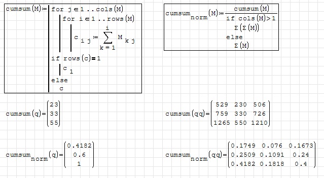

Here's a possible alternative method ...
Stuart
(Unfortunately, I don't seem to be able to attach files ... I can't see an icon or text in either Firefox or Safari)
