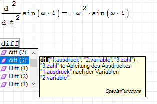

SMath Forum SMath Studio Questions Derivative the 2-d order 1 Pages (3 items) Derivative the 2-d order - Messages Go to last post #1 Posted: 2023/5/29 03:42:44 Valery Ochkov 66 likes in 690 posts. Group: User Is there the Derivative the 2-d order in SMath? I see only 1-st order.Thanks! #2 Posted: 2023/5/29 07:43:03 Martin Kraska 1,355 likes in 2,271 posts. Group: Moderator It is not in the side panel but you can select it in the dynamic assistant or in the Insert functions dialog. Technische Mechanik mit SMath Studio: https://link.springer.com/book/10.1007/978-3-658-50592-9 1 users liked this postValery Ochkov 2023/5/29 08:28:00 #3 Posted: 2023/5/29 08:54:18 Jean Giraud 983 likes in 6,866 posts. Group: User WroteIs there the Derivative the 2-d order in SMath? I see only 1-st order.As well, you can have multiple derivatives.f(x) is the integrand of erf(x)Cheers ... Jean. 1 Pages (3 items) New Posts No New Posts
