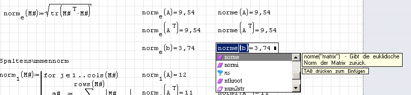

#4 Posted: 2013/5/17 09:29:55
1,308 likes in 2,221 posts.
enorm() seems to work now (with 0.96.4884). The workaround from the customFunctions plugin is switched off here, as the dynamic assistant (invoked by F12) shows.
