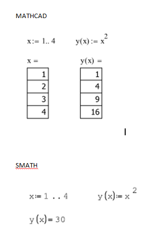

Dear SMATH users
Please help me that how to generate series or table with variable having power.
In Mathcad it is very simple
a simple calcs has been shown belwo with a variable x having power 2. In mathcad it y(x) series can be easily generated, but smath results are not same.
So guide me that how to generate similar calcs in smath.
Shafiq

You need to use the "vectorize function" over the function to get it to work.

1. Vectorise is not available in version 5346
2. Vectorise is local. For more genaral use, universal algo style
is a better choice. Plug the module at the top of the work sheet
collapse and have it in hand further down the WS.

... in the attached, where you have Vectorise(f,zoom), try to write
Z:=f(zoom) under the vectorise operator and see if it works.
But don't zap the existing working Z:=Vectorise(f,zoom).
The grayscale is in the collapsed area, no need to import.
The construction stuff is also collapsed "Fourier"
