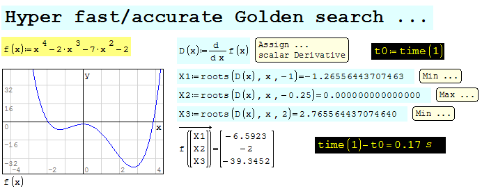

#1 Posted: 2023/5/3 03:08:07
Valery Ochkov
Valery Ochkov
66 likes in 690 posts.
3-MinGR.sm (8.97 KiB) downloaded 1413 time(s).
#2 Posted: 2023/5/3 08:15:21
No need for approximately = ... decrease TOL as needed.
Lot more in there: roots, discrete Golden, Dichotomy ...
Golden ratio QUICK.sm (130.08 KiB) downloaded 1360 time(s).
#3 Posted: 2023/5/3 09:43:06
... if your function is not symbolic differentiable for 'roots':
spline(s), all Smath based built-in ... Instead of 'roots' use solve(4)
