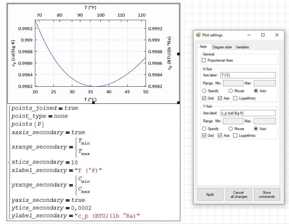

It will be good to have in SMath
2X-2Y.sm (12.9 KiB) downloaded 1588 time(s).

1,355 likes in 2,271 posts.
If you let in Maxima, then you can have it.
2X-2Y_Kr.sm (169.77 KiB) downloaded 1517 time(s).

Martin!
Tell us right away everything that Maxima cannot do!
