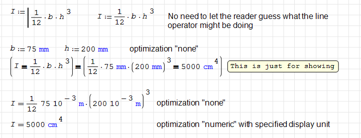

This request can be achieved on a basic level.
Not available with inline numerical results though.
When optimization set to none, variables are shown.

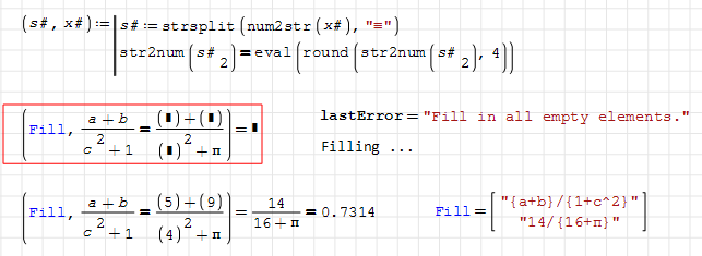

WroteHi. Something like this?
Filling.sm (6.66 KiB) downloaded 1561 time(s).
yea, somthing like that. but this is very unusefull because its complicated to use or i dont know how to use it.

WroteUse the oldest programmation technique: copy, paste and modify only few things. This other?
show.sm (4.44 KiB) downloaded 1460 time(s).

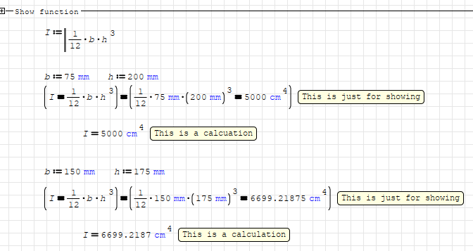

Maybe this works for you.
You have to manually enter expression for show function.
And manually define input units and output units.
And click Display Input Data to hide function section.
At least it shows everything in one line.
ShowVals.sm (14.65 KiB) downloaded 1582 time(s).

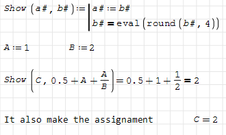

WroteA plugin that make possible to put values into the variables will be great
Algo style for infinite use in-situ.
Algo(x,y,u,v,code).sm (6.33 KiB) downloaded 1454 time(s).

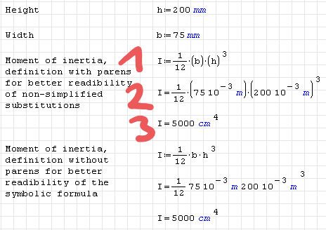

Yes, I agree that display of a formula with substituted but non-simplified input values along with simplified result in the same row would be a valuable feature.
Current limitation:
1. you can't even store input in non-simplified way, the least you have to accept is that units are converted to base units.
2. you can't display non-simplified and simplified result in the same math region.
In paperwork, display of substitutions with both original input units and with converted units makes sense, as you want to check correct conversion separately from correct substitution. In SMath Studio, this holds true for temperature units and angular velocities, where a lot of problems arise from wrong assumptions on conversion behaviour.
So, a step-by-step display would involve
1. display of the formula with substituted input values with original units (not possible currently)
2. display of the formula with substituted input values with converted units
3. display of the result
The first limitation could be overcome by modifying the behaviour of definitions with optimization "none" to verbatim storage, which includes keeping the units untouched.
Probably, storing everything in base units might be a design decision of the developer with a lot of side effects if changed.
Yet, verbatim storage of the input is the critical point here. If that is not implemented, there is no chance to recover the input units in later display whatever equal signs you might invent.
So for now, the best you can get is display of step 2 and 3 in separate regions.
This requires the input definitions and the region for step 2 being in optimization mode "none" and step 3 "numeric".

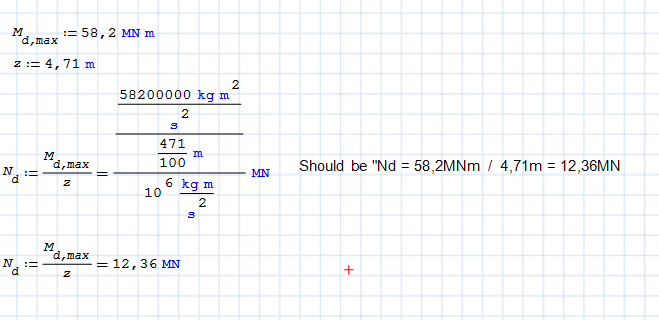

Right, that's my fault in the example that i've given.
But still, at my work it's nescessary to have a good looking schema.
I need the equation that shows Nd = 58,2MNm / 4,71m = 12,36MN, but not Nd = (58,2MNm / 4,71m)/1000000N 'MN = 12,36MN
In construction engeneering there are (almost) only simple equations. But a lot of simple equations. And these equations have to be checked by someone else and must look good that another person could check them quickly.
So unfortunately i'll stay with my work by MS Excel which also isn\t perfect for such tasks.

WroteI need the equation that shows Nd = 58,2MNm / 4,71m = 12,36MN, but not Nd = (58,2MNm / 4,71m)/1000000N 'MN = 12,36MN
That's what I explained, ie: unit system is a sub-processor.
At this point, you depend upon make it respond.
