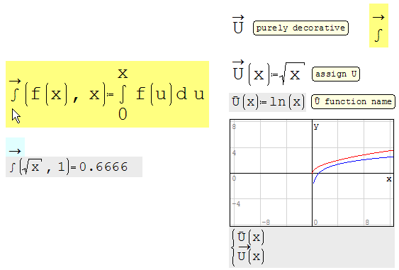

#14 Posted: 2023/5/12 11:46:32
⚜ Kenny Lemens, P.E. ᵂᴵ
85 likes in 180 posts.
Greetings,
This conversation inspired me to test a few things out; apparently you can utilize a newline character within a variable name. Therefore, you don't need to 'draw' an arrow above a variable name, you can contain the arrow and the text within the variable itself!
Insert arrow character(s) and insert 'newline' to type the text of the variable (to insert a new line, paste the newline character: 「\​000​A\」).
Copy and paste the following into SMath:
⟶\000A\abc:456
To make this technique more transparent, I compiled a SMath Sheet (A writer region was used to display the text \000A\ without converting it to a newline character):
Click to enlarge
e.g.,VectorsInSMath_2023-05-12.sm (196.62 KiB) downloaded 1191 time(s).
May this be of Good Help,
- Kenny Lemens, P.E. ᵂᴵ
