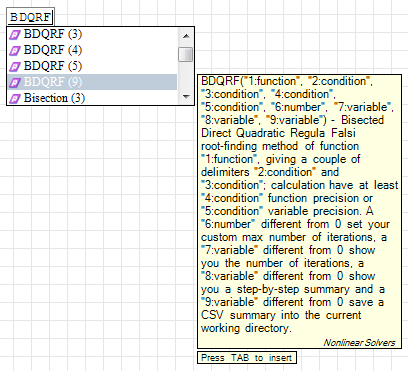

Thank you; what are the parameters of BDQRF? Very confused with the documentation, and your use of (..., 0, 0.1). I thought those were for epsilon and maximum iterations?
EDIT: Answer is found here: https://smath.info/svn/public/plugins/NonlinearSolvers/Primitives/Root%20Finding%20Methods/BDQRF.cs
trySolve(Term[] function, Term[] bound_P1, Term[] bound_P2, Term[] epsilon_fx, Term[] epsilon_Δx, int maxIterations, bool showSummary, bool saveSummary, ref Store context)
Is there any way to improve the resolution, or am I just at the limits of the double-precision floating-point?
EDIT: Previous forum posts indicate otherwise.
#4 Posted: 2017/6/6 15:52:15
1,443 likes in 2,935 posts.
Better you look below for documentation; code entry point is accidentally close to the high-level function, but in general this is not guarantee
Activebook (Tools > Plugins... Interctive books - Online Gallery > Interactive SMath Handbook)
For plotting issues, I suggest to scale down the values (f.e. plot f(x)/10^19 or something similar)
#5 Posted: 2017/6/6 16:50:19
Thank you; what are the parameters of BDQRF ? Very confused with the documentation, and your use of (..., 0, 0.1).
I thought those were for epsilon and maximum iterations ?
ANSWER: generally, solving is by trial/error, much simplified from a graph, especially if the graph runs in
the negative domain. If you have an answer, it should be accurate enough to restrict the upper limit just a
little bit above the first result. As well, if there is only one result, you restrict the lower limit a
little bit below. If you have no graph, and if you use the "solve" bloc, the error message "No real root"
simply means the upper limit is below the result. In that case, the solver can't "navigate" and fails.
Increase the upper limit.
Is there any way to improve the resolution, or am I just at the limits of the double-precision floating-point ?
ANSWER: accuracy depends upon the "crossing angle". The FindRoots interprets =0 as if it would be fnct(x):=0
The "solve" bloc will reject 0 ... you have to code f(x) =[equality] fnct(x). Any solver will range from rough
result to 15 decimals. It has nothing to do with 32/64 floating point, 32 bits floating accommodates > 15 D.
I'm not familiar with BDQRF ... it just happened it did well in your document.
Welcome studio 271. Cheers ... Jean
#6 Posted: 2017/6/6 17:04:53
studio271
studio271
0 likes in 3 posts.
I appreciate the input, thank you. I saw the tooltips, but it was hard to parse what it was telling me to use as parameters.
I am not saying I NEED to have the extra floating-point precision; in fact, it wouldn't change my result enough to pursue this further. But to be petty... it would make a difference and allow a more precise result in my case. :d
SMath got me the results I needed, and I appreciate all the work you fine folks have put into this software!
