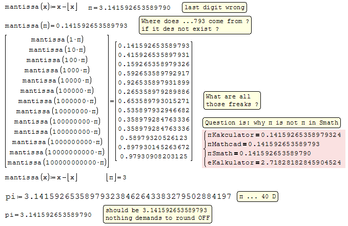

No bug, this is how smath stores numbers.
40 digit numbers are not stored in smath.
Only first 15 digits.
Same is applied with integers too.
Wroteshowing less digits is maybe a glitch maybe a bug.
Looks a bug from Windows that decided to round OFF last digit
Your demonstration is convincing however Smath pi is wrong.
World will have ended but Windows freak will survive.
In short, pi Smath is displayed by Windows c/w its bug.
