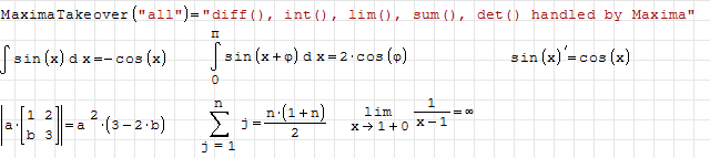

A new portable distribution with Maxima is available (follow the link in my signature).
Based on an update of the Maxima plugin, it's full set of features is back, including the re-direction of integral, limit and sum functions to Maxima. Due to SMath API changes, this was not possible in the release earlier this year. If you use the Maxima features in SMath, I recommend to upgrade.
The Maxima plugin is not yet easy to configure, therefore I recommend to use the ready-to-run portable distribution.
Best regards, Martin Kraska

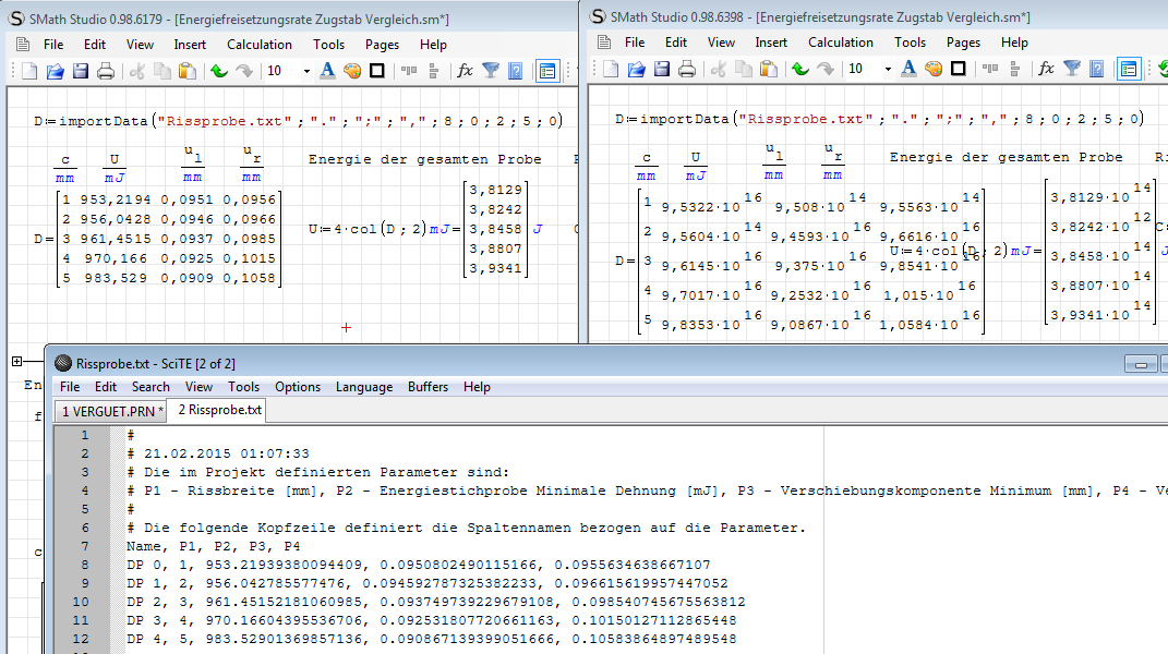

There is a regression in importData. The attached file can't be read correctly. It seems that the decimal separator is ignored at all, no matter to what value it is set.
Rissprobe.txt (695 B) downloaded 581 time(s).
#5 Posted: 2017/8/14 05:24:06
1,435 likes in 2,913 posts.
Confirmed, thank you.
