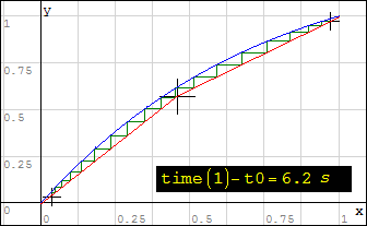

WroteIs it possible to use this method to approximate a function like the one in the picture?
If you have it working in Smath, please attach the document.

I have attempted to construct your picture.
It produces a graph. I see no way to reduce further whereas
it is not simply numerical. If you leave it this way, then
it will track the parameters [R0, Lo, k, a] which are
presumed resulting from previous calculations.
Does it help ? ... Jean

... at this point, your continued fraction if numerical
can be reduced to J_Fraction of substantial visibility.
You will have to carry the manual procedure for each
numerical valued system ... observe the β construction
Please give news ... Jean

Wow!!!!! Thanks for you ultra very quickly answer
I thought about using Thieles interpolation too. but I don't understand how adapt this function for my needs, because I am very far in this area of knowledge.
THIELE_INTERPOLATION_ AND_REGRESSION_SS7251.sm (210.63 KiB) downloaded 796 time(s).
This's example from CBG(It's user this forum) and I wanted used it.
