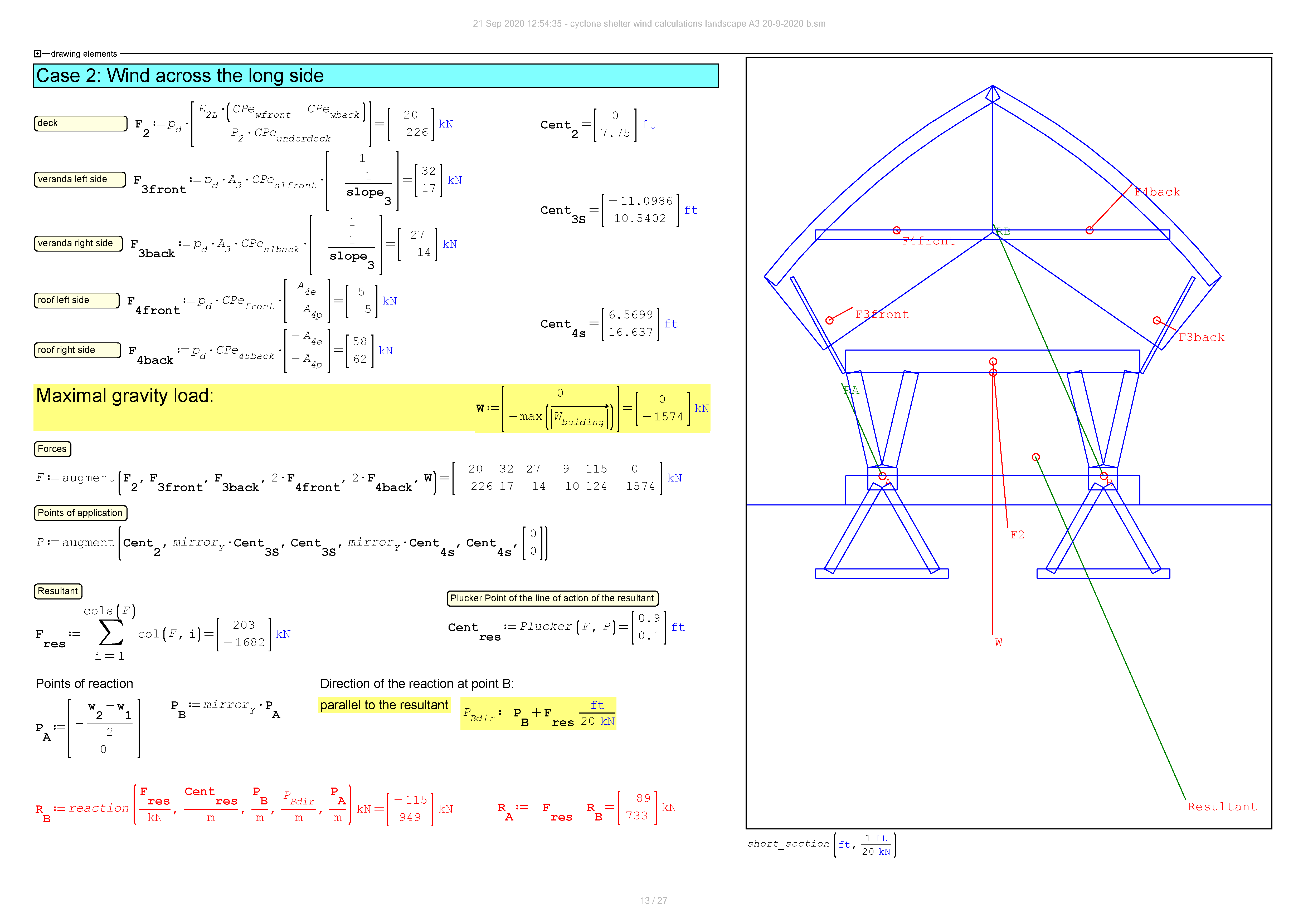

Hello, it would help making nicer engineering sheets if the plot regions could be placed side-by-side with the data entered, and not below it. Because generally we like to see what is the result, graphically, of the data entered just as we enter it, and not scroll down.
To achieve that I sometimes use global variables, but the problem with these variables is that their value can be assigned only once, so it doesn't allow copy-paste of blocks of calculations/plots, which is a very, very convenient feature of smath, for comparing load cases for examples. So if I want my plot side-by-side with the calculation I have to use global variables (which are also slow and require 2 times and sometimes 3 times evaluation) and one different sheet per load case which is also not convenient.
I wonder if it would be possible to allow a plot region to use all the variables defined above the BOTTOM of the plot, and not just those defined above the top. Since the plot in itself doesn't change any variable value, I guess it should be possible. Just a sort of "shifting the window upwards".
Attached below an example of wind calculation for a bamboo cyclone shelter, illustrating how the calculations can be made easier to understand when the plot besides and not under them. This sheet is made with global variables. The plot elements are defined in the collapsed region called "drawing elements" just on top of the page. I like this look as it allows easy verification of the data and possible errors, with the plot just next to it, but it doesn't allow copy-pasting of this page in the same sheet unless we create new variables for each case, which is cumbersome.
Thank you,
Laurent

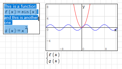

You could use a text region with embedded math. Then everything inside is available outside starting from the top left corner of the region. Inside the region the sequence is serial according to text flow.
![2020-09-21 12_30_43-SMath Studio - [Blatt7_].png](/zh-Hans-CN/files/Download/BxvPoq/2020-09-21-12_30_43-SMath-Studio---[Blatt7_].png)
textregion.sm (3.41 KiB) downloaded 842 time(s).
Andrey Ivashov 2020/9/21 18:27:00
Dear Martin, that's fantastic!
I also just read the thread on "Edit workflow for text regions with embedded math" and I think Andrei's project is just spot-on! He is right, in calculations a clear, simple and beautiful presentation is everything. After all a calculation is a concept, and in conveying a concept, aesthetics is essential, not accessory...
Thank you so much for your so quick help.
Thank you dear Andrei for making such a wonderfully simple software, where freedom is at the core, available for free!
Laurent

WroteYou could use a text region with embedded math. Then everything inside is available outside starting from the top left corner of the region. Inside the region the sequence is serial according to text flow.
I was not aware of this feature, this software is getting better by the day

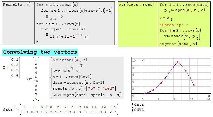

WroteYes this software is getting awesome, very efficient,
Revisit the last example ... !
Fourier Convol Kernel Algebra.sm (86.59 KiB) downloaded 888 time(s).
