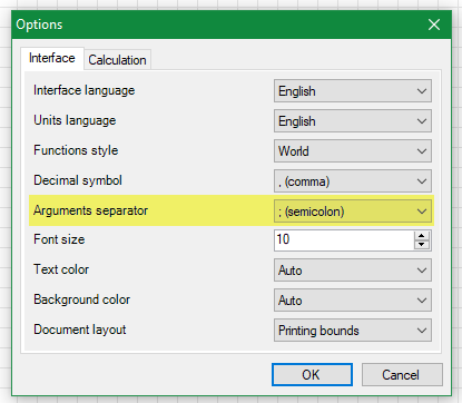

Unfortunately it is not possible using the comma ',' to separate indices of a matrix. Instead a subscript is produced

Hello [userlink]Efried[/userlink],
please check in your program settings (Tools > Options) what is the character assigned to arguments separator
Andrey Ivashov 2018/2/15 11:51:00

many thanks, indeed that is different from Mathcad and wonderfully configurable.
