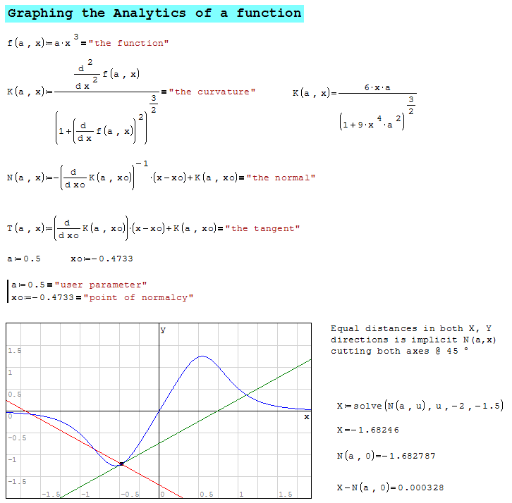

Hello Basile,
If you can solve by trial/error, quickly enough: a "While" loop should do so.
Try to implement the "While" loop. Some collab may fancy doing it.
Cheers, Jean
