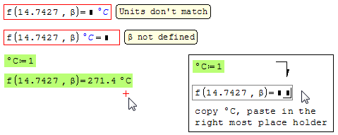

Hello, I would like to consult you
                                                I define a temperature in degrees Centigrade, when I call it it looks like Kelvin degrees and then I can't make a sum because it tells me they are two different units. How can I do so that the defined temperature is maintained in every calculation in the unit that defined it?
Attached image capture of the problem.
Thank you
#9 Posted: 2019/9/29 04:22:37
There are many posts on the Forum about handling tempereture units. See for example this one.
frapuano 2019/9/29 08:28:00

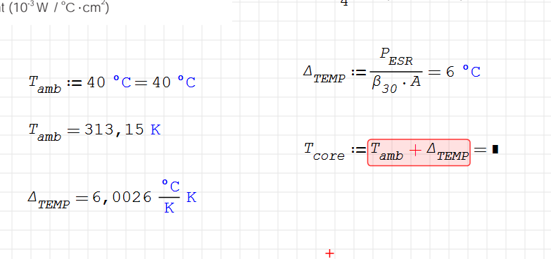

#10 Posted: 2019/9/29 07:46:27
Smath Unit System is ISO, °C is not ISO.
Define your user unit.
If user unit is not '1', don't multiply input by user.

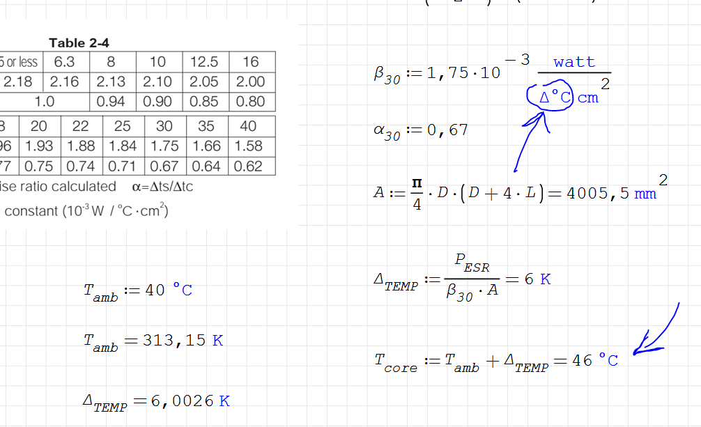

#11 Posted: 2019/9/29 09:37:54
Visit Colebrook, suggestive how to carry Engineering projects.
And recover units in the results. Each project is specific.
Please, feel free to attach your project for more doctoring.
Inst_Colebrook Pipe Data.sm (61.76 KiB) downloaded 1057 time(s).

#14 Posted: 2019/9/29 19:03:50
ry practice ignoring unit system.
Only OK for baby stuff: 2*2=4m²
#15 Posted: 2019/9/29 22:06:13
The difference operator is often useful.
