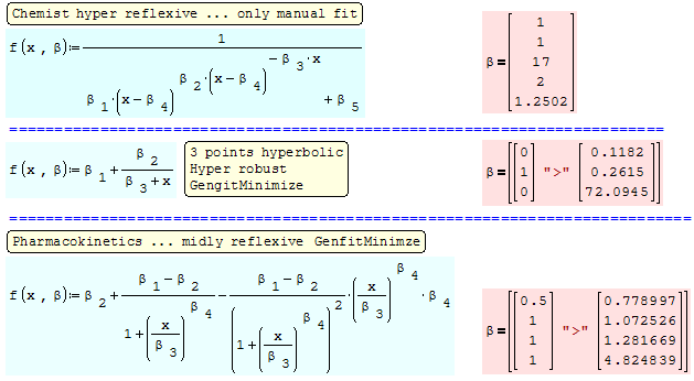

For this particular example, Carlos algorithm spits out in < hart beat !
Thanks again Carlos, it will surely help revamp some/many of the GenfitMinimize.
Shina
You are right About LM, however not so simple.
al_nleqsolve, LM, ConjugateGradient that produce in Smath, all dependent
upon initials and reflexivity of the model +++ the approach technique.
Data reduction is a great approach technique [Kirby, Thermocouples ...]
In Mathcad LM as well as CG, a technique that works well to initialize
wrt many models is to pass manually initials through 2 points.
That was not explored with Carlos LM.
That technique through 2 points did work well in some Smath fit,
but failed in other fits. Maybe you are working hard on that stuff ?
Attached for the interest of this visit.
Genfit Chemist.sm (34.16 KiB) downloaded 1141 time(s).
Genfit Minimize Rational KHL.sm (45.36 KiB) downloaded 1110 time(s).
Genfit Pharmacokinetics.sm (41.84 KiB) downloaded 1138 time(s).
